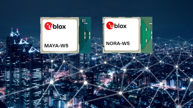

The MAYA-W5 and NORA-W5 modules
The MAYA-W5 and NORA-W5 modules provide Wi-Fi 6 and Bluetooth LE connectivity.

While both module families are built around Texas Instruments wireless chipsets, they will target different system structures. The MAYA-W5 series uses the TI CC3351 chipset and operates as a host-based module, providing dual-band Wi-Fi 6 over an SDIO interface and Bluetooth LE 5.4 over UART. The module measures just 10.3 mm x 14.3 mm x 1.9 mm and includes an integrated PCB antenna.
The NORA-W5 series is based on TI's CC3501 and CC3551 devices and incorporates an onboard 160-MHz Arm Cortex-M33 MCU, enabling the chip to operate as a standalone wireless subsystem. Depending on the variant, NORA-W5 supports single-band or dual-band Wi-Fi 6, Bluetooth LE 5.4, 4 MB or 8 MB of flash memory, and either an integrated or an external antenna. Module dimensions range from 10.4 mm x 11.2 mm to 10.4 mm x 14.3 mm depending on the configuration.

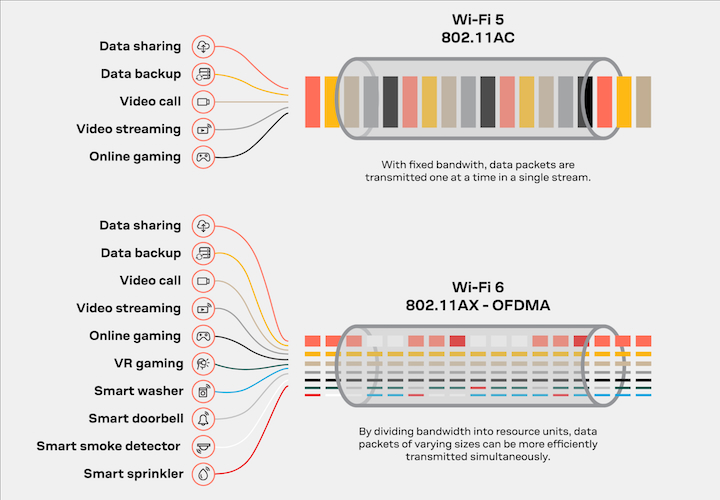

Wi-Fi 6 uses OFDMA technology
Wi-Fi 6 uses OFDMA technology to allow multiple connected devices to share network resources more efficiently.
