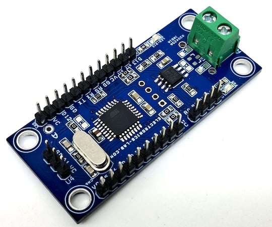

The RS-485 Linear Hall Sensor Interface Board is an Arduino-compatible module built around an ATmega328 microcontroller. It combines two Texas Instruments products: a SN65HVD08DR half-duplex RS-485 transceiver with a DRV5053 linear Hall-effect sensor on a single board. This creates a self-contained node that measures magnetic fields and reports data over an industrial RS-485 network.
Header connectors break out multiple I/O lines, and the board includes a footprint for an optional 0.96-inch OLED display. This makes it useful as both a sensor node and a general-purpose RS-485 development platform. Figure 1 shows the assembled board.
A simple, practical application is an ON/OFF control system that operates over RS-485. Screw terminals handle the RS-485 A and B twisted-pair connections. All other signal lines break out onto 2.54 mm header connectors for easy interfacing with other boards, sensors, or an Arduino programmer.
The DRV5053 Hall sensor outputs an analog voltage proportional to magnetic field strength and polarity. The onboard ATmega328 reads this voltage on an analog input and transmits the value over the RS-485 bus, allowing the reading to be monitored or acted on remotely. In tests, the sensor produced ADC readings of roughly 6 for the south pole, 220 for centered (no field), and 440 for the north pole.
Figure 1. The assembled RS485 Linear Hall Sensor Interface Board.
Figure 1. The assembled RS-485 Linear Hall Sensor Interface Board.

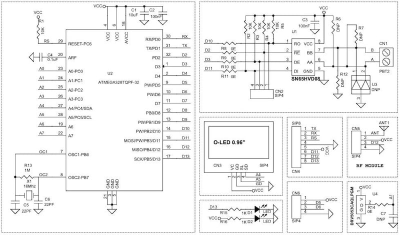

Schematic and Bill of Materials
Figure 2. Schematic of the RS485 Linear Hall Sensor Interface Board.
Figure 2. Schematic of the RS-485 Linear Hall Sensor Interface Board.
The bill of materials is shown in Table 1.

U1 SN65HVD08, SOIC-8 1 TI DigiKey 296-39173-1-ND
U2 ATmega328, TQFP-32 1 Microchip DigiKey ATMEGA328-AU-ND
U3 SM712 - Do Not Install 1
U4 DRV5053CAQLPGM 1 TI DigiKey 296-DRV5053CAQLPGMTB-ND

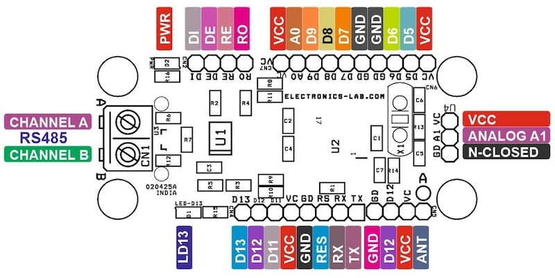

Connections
Figure 3. Connector and pin locations on the RS485 Linear Hall Sensor
Interface Board.
Figure 3. Connector and pin locations on the RS-485 Linear Hall Sensor Interface Board.
CN1 — RS-485 Screw Terminal (2-pin, 5.08 mm pitch):
  • Pin 1 = RS-485 Channel B
  • Pin 2 = RS-485 Channel A
CN2 — Optional Header (4-pin, 2.54 mm pitch):
  • Not used in the standard configuration
CN3 — OLED Display Header (4-pin, 2.54 mm pitch, I2C):
  • Pin 1 = VCC
  • Pin 2 = GND
  • Pin 3 = SLA (SCL)
  • Pin 4 = SDA
CN4 — Programming/Bootloader Header (8-pin, 2.54 mm pitch):
  • Pin 1 = TX
  • Pin 2 = RX
  • Pin 3 = Reset
  • Pin 4 = GND
  • Pin 5 = VCC
  • Pin 6 = D11
  • Pin 7 = D12
  • Pin 8 = D13
CN5 — RF Module Header (4-pin, 2.54 mm pitch, optional 433 MHz ASK):
  • Provision for an optional 433 MHz ASK RF module
CN6 — I/O Header (4-pin, 2.54 mm pitch):
  • Pin 1 = VCC
  • Pin 2 = D5
  • Pin 3 = D6
  • Pin 4 = GND
CN7 — I/O Header (6-pin, 2.54 mm pitch):
  • Pin 1 = VCC
  • Pin 2 = A0
  • Pin 3 = D9
  • Pin 4 = D8
  • Pin 5 = D7
  • Pin 6 = GND
U4 — Magnetic Sensor Header (DRV5053):
  • Pin 1 = VCC
  • Pin 2 = Analog A1
  • Pin 3 = GND
Indicator LEDs:
  • D1 = Function LED, connected to D13
  • D2 = Power LED

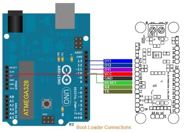

Arduino Programming and Bootloader
The board is bootloaded and programmed through CN4 using an external Arduino Uno as an ISP-style programmer. Wire the Uno's D13, D12, and D11 to the matching pins on CN4, connect 5 V and GND, and tie the Uno's RESET, RX, and TX lines to CN4's Reset, RX, and TX pins as shown in Figure 4. This setup lets the Arduino IDE bootload the ATmega328 and upload firmware directly to the board.
Figure 4. Wiring an Arduino Uno to CN4 to bootload and program the
board.
Figure 4. Wiring an Arduino Uno to CN4 to bootload and program the board.

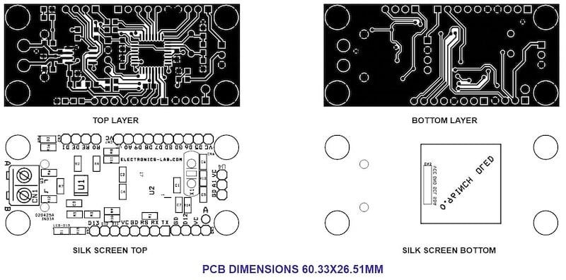

PCB and Code Files
Figure 5. PCB layout of the RS485 Linear Hall Sensor Interface Board,
showing the top and bottom copper layers and silkscreen.
Figure 5. PCB layout of the RS-485 Linear Hall Sensor Interface Board, showing the top and bottom copper layers and silkscreen.
You can download the layout files for this project here:
