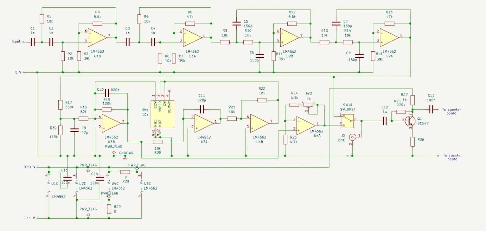

We intend to use this filter to investigate the effects of airborne, low-frequency ultrasonic emissions. Figure 1 shows the complete circuit diagram of the design.
Figure 1. Complete circuit diagram for the tunable ultrasonic filter.
Figure 1. Complete circuit diagram for the tunable ultrasonic filter. [click to enlarge]

Apart from the frequency counter, which we adapted from a commercial kit, the system incorporates three individual filters:
  • A high-pass filter to attenuate audio-frequency signals.
  • A low-pass filter to attenuate ultrasonic signals above 60 kHz.
  • The tunable band-pass filter itself.
High-Pass Filter
The high-pass stage is a 4th-order, maximally flat filter built around U1A and U1B. According to its datasheet, the LM4562 op-amp is actually intended for ultra-low distortion audio processing.
The device achieves its high gain-bandwidth product (GBW) through a very high open-loop gain rather than a high open-loop ft. Regardless, it performs well in this project.
The topology is a Sallen-Key (S-K) filter. A standard S-K filter uses unequal capacitor and resistor values in the RC networks between the signal and the op-amp input. It also uses a gain of 1 so that the pass-band output voltage equals the input voltage.
However, we can use equal capacitor and resistor values if we increase the gain by a specific amount. We achieved this by using the two feedback resistors, R3 and R4.
This configuration gives a stage gain of 2.44, or 7.7 dB. We placed this filter first in the signal chain because the audio-frequency range is where large signals are most likely to occur. Attenuating them early prevents later stages from overloading.
Note: These active filter topologies are described in detail in textbooks like Don Lancaster’s Active Filter Cookbook.
Low-Pass Filter
The low-pass stage is also a conventional 4th-order, maximally flat filter. It is formed around U2A and U2B. Like the high-pass section, it uses a Sallen-Key equal-component circuit with a pass-band gain of 2.44 (7.7 dB).
Most signals in the ultrasonic range above 60 kHz are likely to be weak. However, we cannot rule out strong interfering signals. Attenuation in this high-frequency range is necessary.
Tuneable Band-Pass filter
This stage uses a biquad filter topology. Biquad circuits can provide low-pass outputs alongside the desired band-pass output.
The circuit consists of a chain of two integrators (op-amps U3A and U3B) with capacitive feedback, followed by an inverter (U4B). In variations of this circuit, the inverter can be placed either first or second in the three-stage chain.
A notable feature of this layout—with the inverter as the third stage—is that the band-pass output is taken from the first op-amp in the chain.
RV1 serves as the tuning control. In this configuration, the frequency is proportional to the square root of the resistance. Therefore, a 9:1 resistance range yields a 3:1 frequency range.
Supporting Circuitry
U4A is a non-inverting buffer. It features a trimmable gain control to set the overall system gain to 1 at peak frequencies. SW1A is not a London postal district a three-position, but a center-off switch. It routes different signals to the BNC connector J2:
  • A wide-band output from before the band-pass filter.
  • An isolated input for the counter alone.
  • The final band-pass filter output.
Q1 serves as a preamplifier for the frequency counter. Although it is a standard audio transistor, it performs well up to at least 20 MHz in this circuit layout.
A PC board design is not included, because it had to be a special shape to fit into the box.

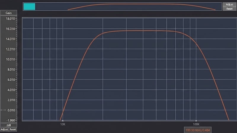

Figure 2 shows the wide-band response of the first two filters, available at J2 as described above. This output is fed into a spectrum analyser to see the amplitudes and frequencies of all ultrasonic signals captured by the sound level meter or a microphone and preamplifier. The wideband frequency response is 3 dB down at 16 Hz and 100 kHz.

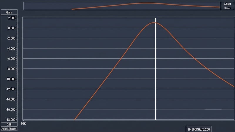

Figure 3 shows the frequency response of the entire filter chain when tuned to peak at 20 kHz.

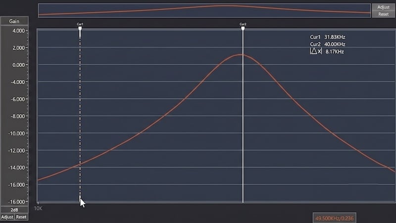

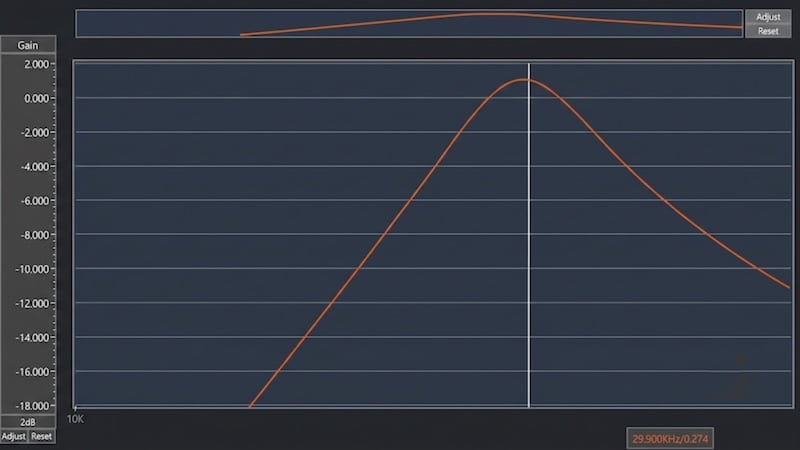

Figure 4 shows the system response when tuned to 30 kHz. Note that the bandwidth does not widen from its width at 20 kHz.

Figure 5 shows the frequency response when tuned to 40 kHz. Once again, the bandwidth remains nearly constant at 4 kHz.

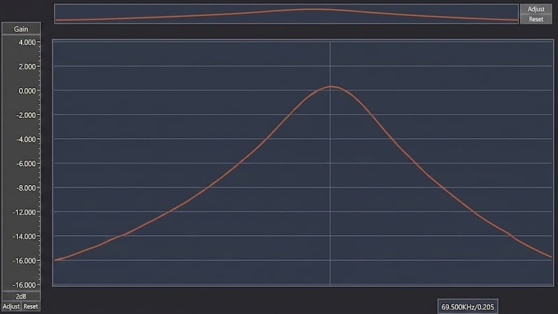

Figure 6 shows the frequency response when the filter is tuned to 60 kHz.
