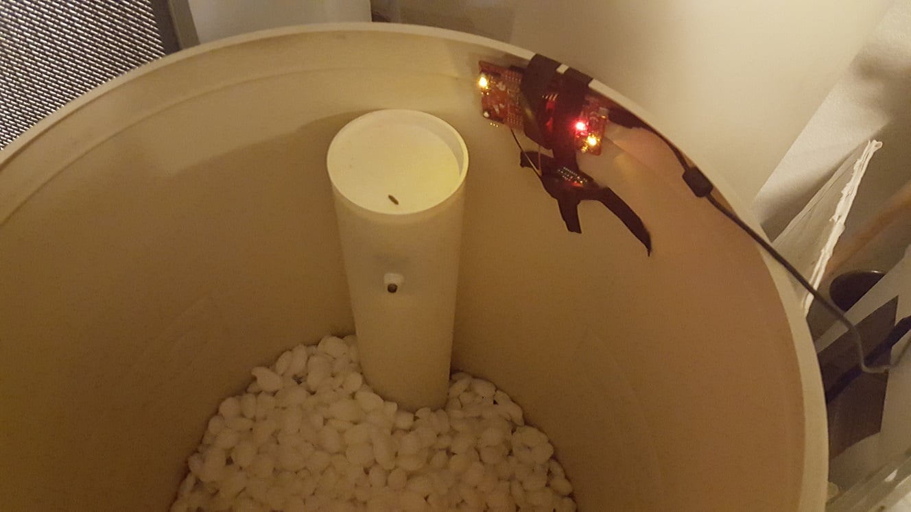

  6. To calibrate the sensor for you water softener, mount the sensor where you intend to place it inside the softener. I mounted mine temporarily with tape. For a permament solution, you would want to use screws or glue, ideally in a project case.
  7. Remove salt until it is at a level you want the sensor to show 0%.
    1. Make note of the raw data value being reported.
  8. Put a handful of salt in your hand and move it towards the sensor where you want to show 100%.

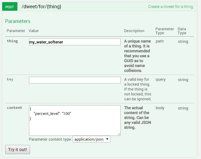

Setup dweet.io
dweet.io
  1. Go to https://dweet.io/play/
  2. Click "Create a dweet for a thing"
  3. Fill in the parameters for the thing and the content. Choose a thing name that is very unique unless you plan to pay for a "locked" thing, otherwise people can easily view it or change it. We want to display the water softener percent_level, so that is the content. It must be a valid JSON string.

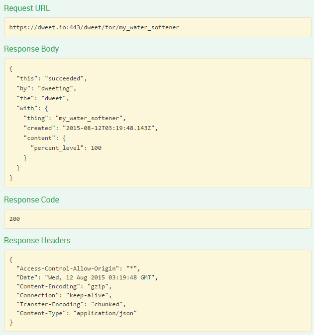

  4. Click "Try it out!" to see what will happen when posting to the dweet. The request URL is what we'll use to post from the CC3200.
Post to dweet.io from the CC3200
The following code will connect to the dweet.io setup in the previous setup and post the percent value of the water softener. It works by opening a connection to the HTTP server of dweet.io on port 80 and requesting the webpage using the GET function. This is the same as pasting the URL in the previous section into a web browser to write a value.

  6. Open the terminal, Ctrl+Shift+M, and you will see the salt level uploaded once a second.
  7. Wave your hand near the sensor to see the number change and view realtime at the URL of your thing.
    1. This article uses https://dweet.io:443/get/latest/dweet/for/my_water_softener
    2. Here is the output:
      {"this":"succeeded","by":"getting","the":"dweets","with":[{"thing":"my_water_softener","created":"2015-08-14T02:40:59.181Z","content":{"percent_level":21}}]}

  • T
    texasclodhopper August 27, 2015
    I’d be really surprised if your electronics didn’t suffer some adverse affects from being in the same closed environment with all that “salt.”
    Like. Reply
  • B
    bgwiz March 03, 2016
    @texasclodhopper I agree.  Living in MN, we watch cars slowly get ‘eaten’ by the salt used in the winter.
    Just keep everything except the proximity sensor far away and all should be good as long as the sensor is sealed well.
