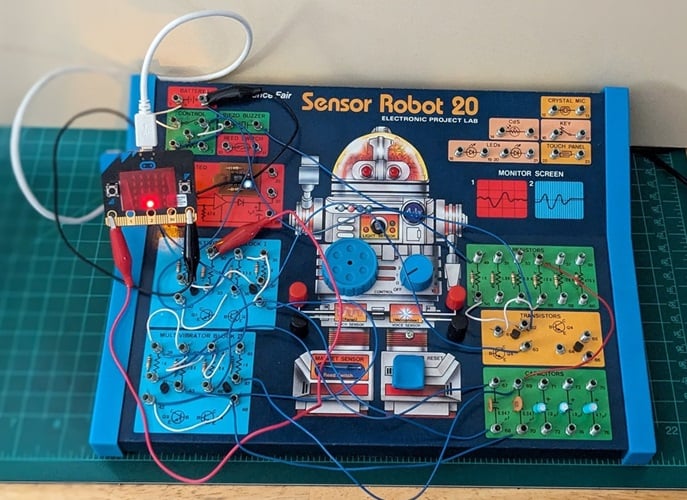

Figure 1 shows the completed project, which we’ll call the Remixed Brightness Alarm.

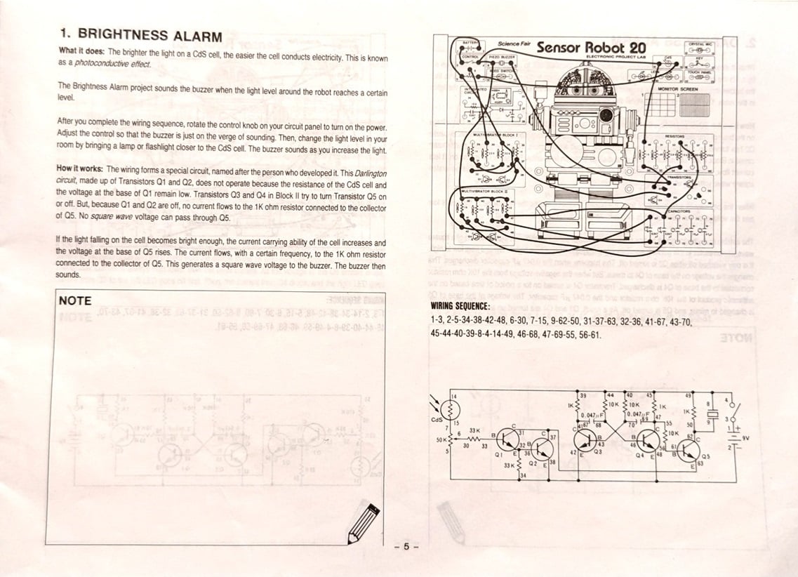

The Classic Brightness Alarm Project
Figure 2 shows the original Brightness Alarm project instructions as they appeared in the Sensor Robot lab manual.
The Brightness Alarm project instructions from the original Sensor Robot 20 manual.
Figure 2. [Click to enlarge] The Brightness Alarm project instructions from the original Sensor Robot 20 manual. Image used courtesy of Don Wilcher

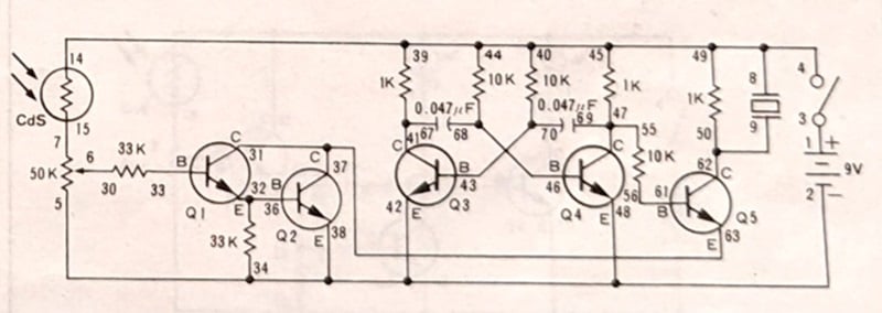

Figure 3 provides a close-up view of the circuit schematic.
Brightness Alarm schematic from the original manual.
Figure 3. The Brightness Alarm schematic from the original manual. Image used courtesy of Don Wilcher
This version of the Brightness Alarm includes five electronic subcircuits:
  1. The cadmium-sulfide light sensor (I4).
  2. The 50 kΩ potentiometer.
  3. The Darlington circuit (Q1 and Q2).
  4. The astable multivibrator (Q3, Q4, and RC loads).
  5. The transistor-driven piezo buzzer circuit (Q5 and the piezo crystal).
The classic project uses a cadmium-sulfide (CdS) photoresistor to detect light. CdS photocells change their resistance based on the intensity of light falling on them. The sensitivity of the light detector is controlled by manually adjusting the potentiometer.
The Darlington circuit, astable multivibrator, and piezo buzzer circuit are present in both the classic and remixed versions of the project. We’ll discuss their operation later on in the article. However, the remix of the Brightness Alarm replaces the CdS cell and the 50 kΩ potentiometer with a micro:bit microprocessor board. This feature upgrades the classic Brightness Alarm to a programmable light sensor capable of logging light level data and digitally adjusting the detection threshold.

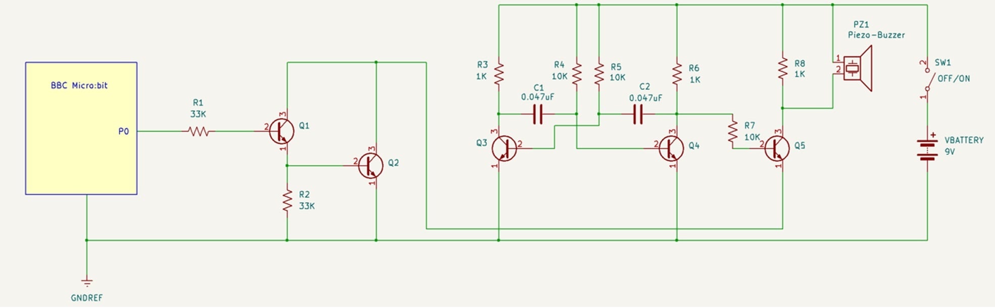

We're now ready to put everything together. Figure 7 shows the the complete schematic for the Remixed Brightness Alarm.
Schematic for the Remixed Brightness Alarm.
Figure 7. [Click to enlarge] The Remixed Brightness Alarm schematic. Image used courtesy of Don Wilcher
Most of the wiring instructions are the same as they would be in the classic version of the project. You can find these instructions in Figure 2. However, we still need to connect the micro:bit to the rest of the device. This is done using two test leads with alligator clips.
Figure 8 illustrates the two wiring connections between the micro:bit and the Sensor Robot kit. I’ve color-coded the two test leads for ease of reference.
Wiring the micro:bit to the Sensor Robot kit.
Figure 8. The micro:bit is connected to the Sensor Robot kit via two test leads, one attached to P0 and the other to GND. Image used courtesy of Don Wilcher
The procedure is as follows:
  • Connect one end of the red test lead to pad P0 of the micro:bit and the other end to spring terminal 30 of the Sensor Robot kit. Spring terminal 30 connects to the 33 kΩ series resistor that biases the Darlington pair.
  • Connect one end of the black test lead to the micro:bit’s GND pad and the other end to spring terminal 3 of the kit. Spring terminal 3 is the negative/ground side of the Sensor Robot kit’s 9 V battery.
