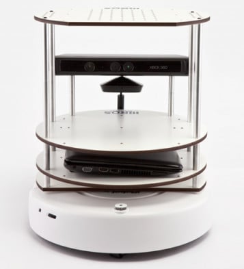

Turtlebot Example: Running a Gazebo Simulation Environment
As a small test, we will run a simulation environment called Gazebo for a Turtlebot robot.
Turtulebot
The Turtlebot. Image courtesy of Willow Garage.
