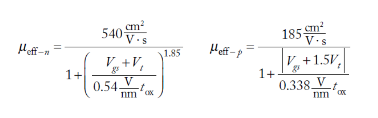

Velocity Saturation and Mobility Degradation
Velocity saturation results in lower Ids at high Vds (saturation mode). Because higher voltage causes higher electric field strength along the channel, which causes the carrier to collide more often, hence results in mobility degradation of the carrier.
The carrier is also having physical limitation hence it can only maintain a certain maximum average speed, this is called velocity saturation. A universal model that matches this scenario is given in (Chen, et al., 1997) and (Chen, Hu, Fang, Lin, & Wollesen, 1997), where the mobility (µ) was replaced by the effective mobility (µeff).

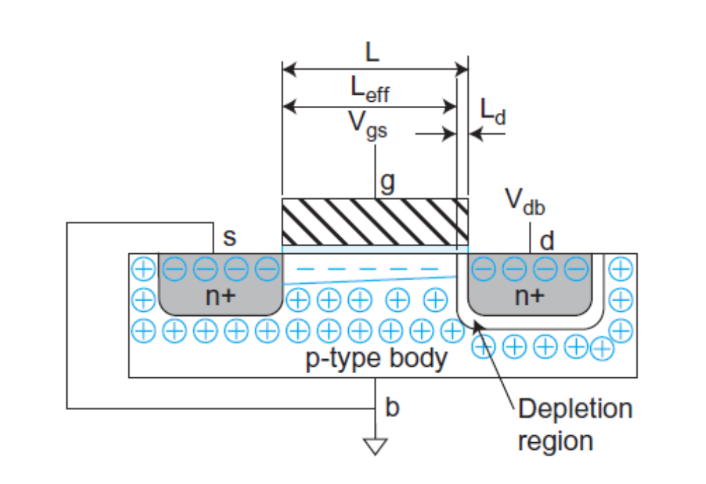

Channel Length Modulation
In an ideal transistor, Ids is independent of Vds when the transistor is in saturation mode, making the transistor a constant current source. But in reality, Vds (drain-source voltage) causes a depletion layer (Ld) along the walls of the channel, which makes the effective channel length less than the actual channel length, thereby making the effective length (Leff = L – Ld).
Consequently, as Vds increases, Leff gets relatively shorter, hence causing reduced lateral field strength. Since electric field strength (E) is proportional to the length of the channel. This reduced field strength pushes Ids variability back to the linear region, which makes Ids increases with Vds in saturation.
Figure 2. Depletion region shortening effective channel length
In this case, Ids can be better modeled by multiplying it by a factor dependent in the early voltage VA as described in (Gray, Hurst, Lewis, & Meyer, 2001).

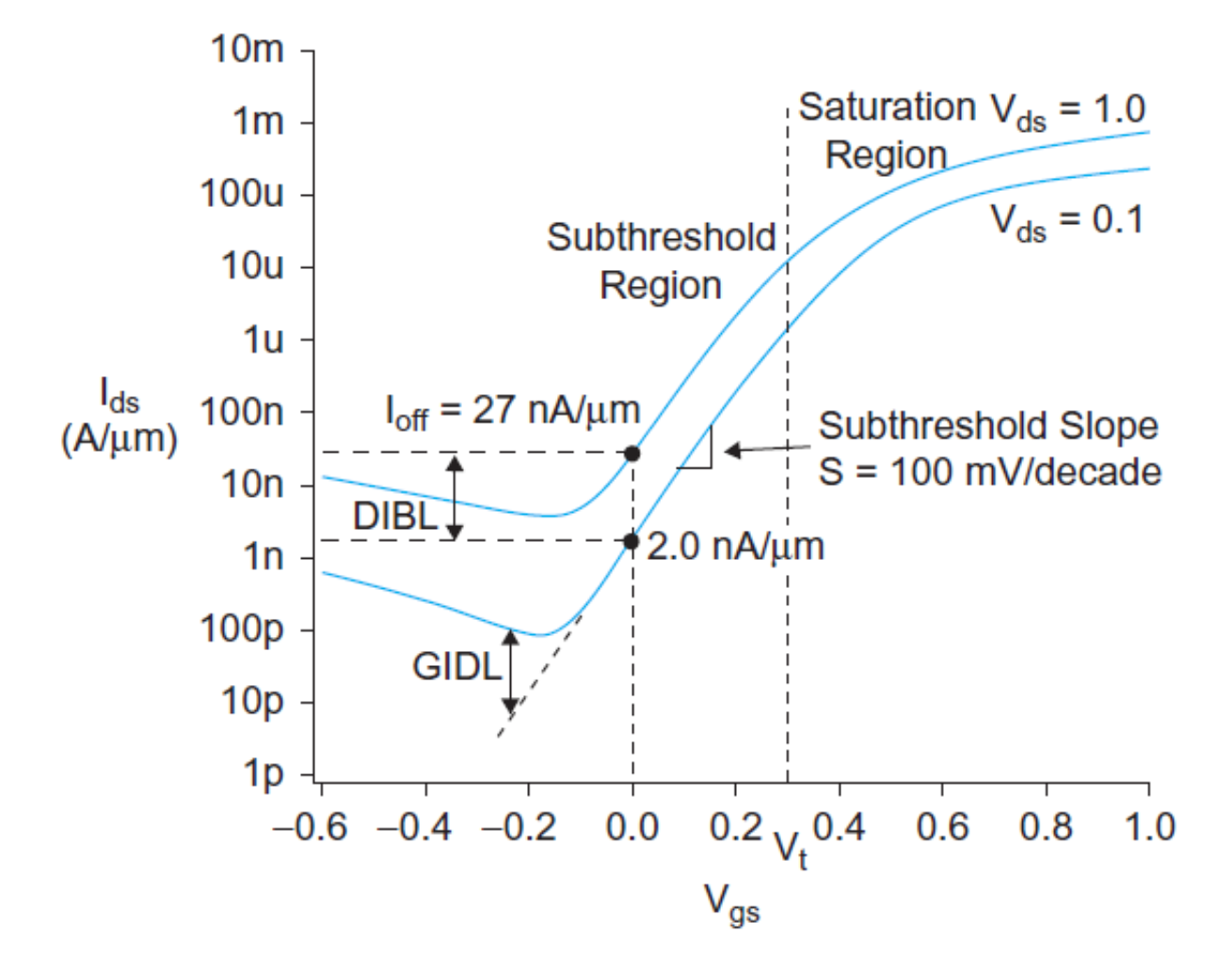

Leakage
When the transistor is OFF, it is assumed that the drain-source current is zero. In the actual sense, they leak a small amount of current due to subthreshold conduction and junction leakage.
For subthreshold leakage, it is assumed that the current Ids are zero when Vgs < Vt, but in reality, the current drops faster in this operating condition. As Vgs lowers to a negative value, it forms what is called weak inversion as shown in Figure 3:
Figure 3. IV-characteristic showing exponential fall of Ids at Vgs < Vt
