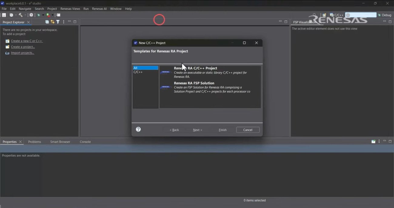

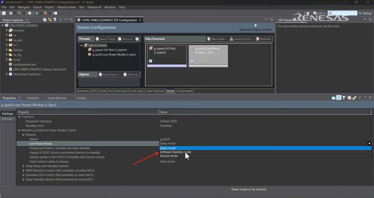

Step 1: Add the Low Power Mode Stack

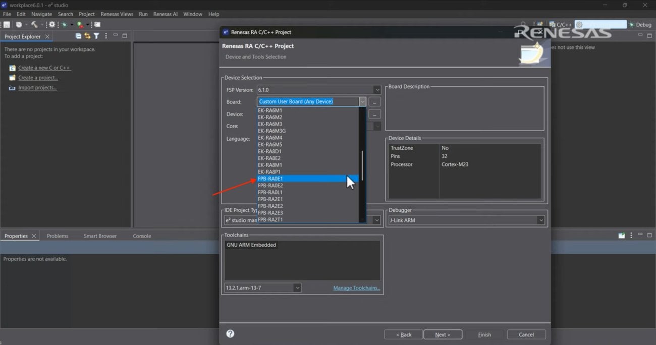

- Create a new C/C++ project for the FPB-RA0E1.
- Open your FSP Configuration, navigate to the Stacks tab, and add the Low Power Modes (r_lpm) stack. Doing this primes the power management controller to handle deep sleep transitions.
Step 2: Configure the Wake Source

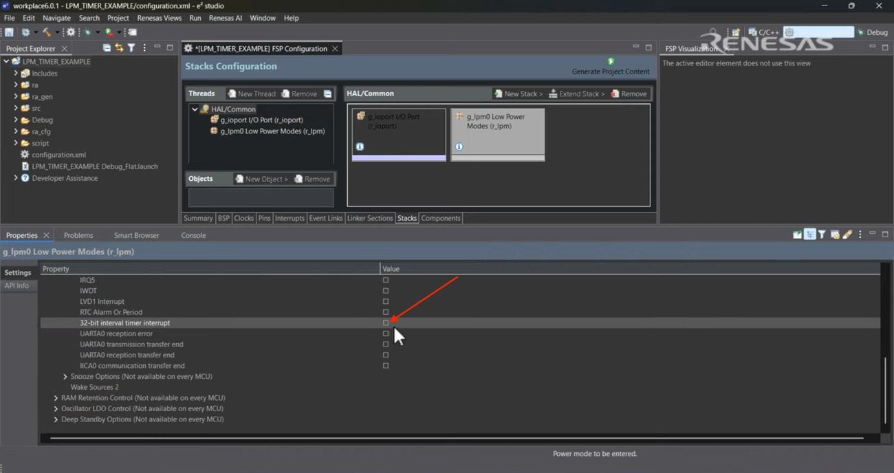

- In the properties for the Low Power Mode stack, set the Low Power Mode to Software Standby mode.
- Scroll down to the Wake Sources and check the box for 32-bit interval timer interrupt. This step tells the core exactly which signal is allowed to interrupt its slumber.

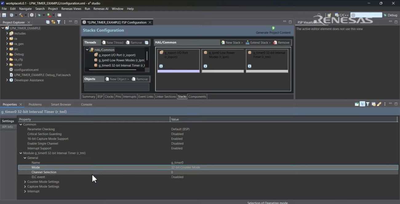

Step 3: Add the 32-Bit Interval Timer
- Return to the Stacks tab and add the 32-bit Interval Timer (r_tml) stack. In properties, ensure it is set to 32-bit Counter Mode and assign any valid interrupt priority (we use 2 here).

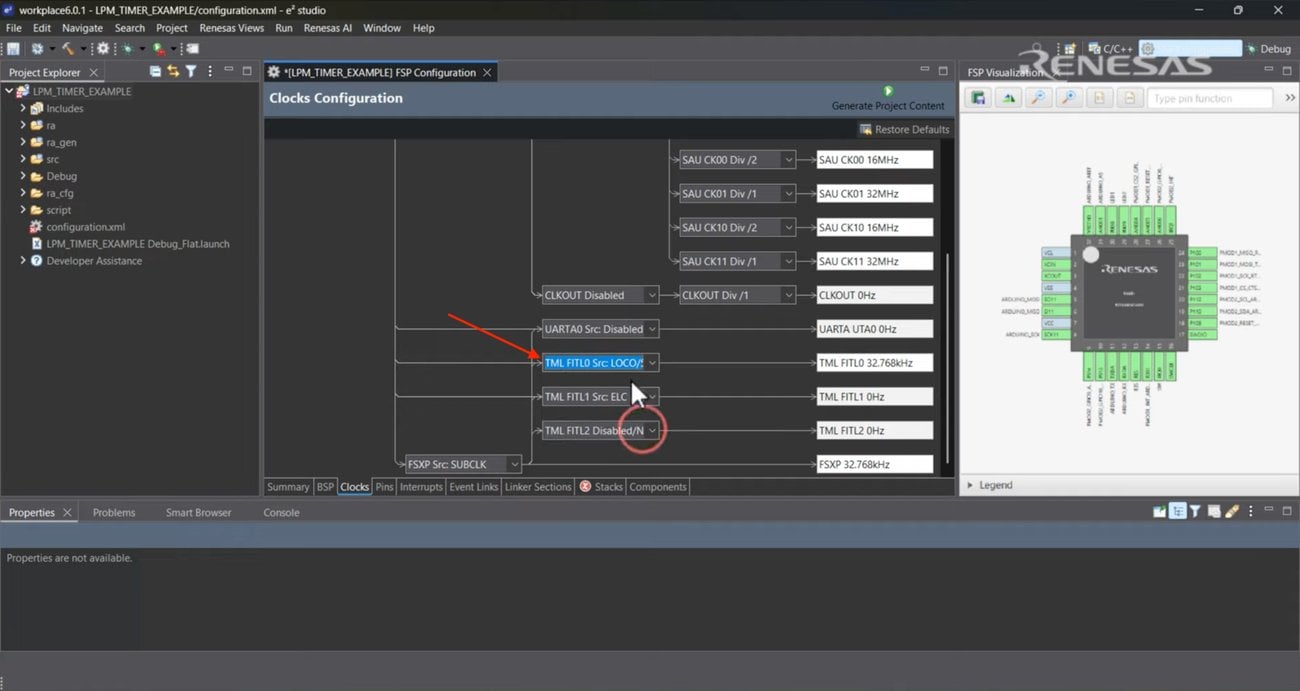

Step 4: Route the Low-Power Clocks
- Navigate to the Clocks configuration tab. Set the TML FITL0 Src selector to LOCO (Low-Speed On-Chip Oscillator).
FITL0 is a configurable input. It can be driven from HOCO, MOCO, MOSC, or LOCO/SOSC, but only the LOCO or the sub-clock oscillator (SOSC) keeps running in Software Standby. Routing the timer's count clock through LOCO ensures that it keeps ticking after the power-hungry, high-speed clocks are shut off during sleep.

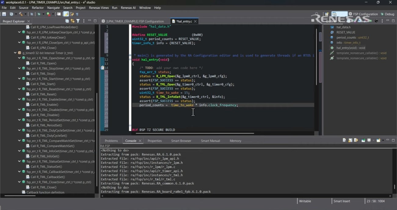

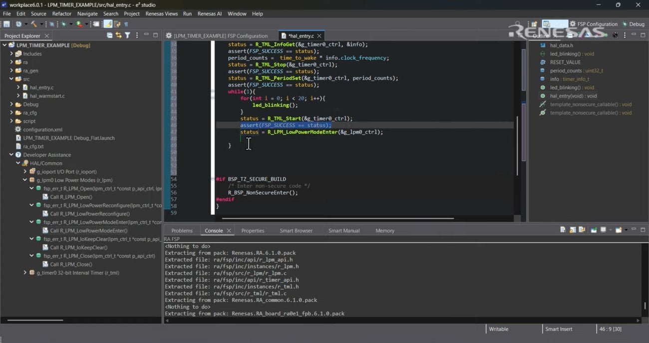

Step 5: Initialize Peripherals in Code
- Generate your project content and open hal_entry.c.
- Drag the R_LPM_Open and R_TML_Open API calls from Developer Assistance into your code before the main loop. Initializing these modules locks your FSP GUI configurations to the underlying hardware registers.
Step 6: Calculate the Wake Interval
- Define a target sleep time variable (for example, 15 seconds). Use R_TML_InfoGet to retrieve the timer's clock frequency and multiply this frequency by your target time to determine the total period counts. Calculating this dynamically prevents timing bugs if you alter the oscillator speed later.
Step 7: Execute Sleep Logic
- Inside your execution loop, configure onboard LEDs to blink using R_IOPORT_PinWrite to prove the board is awake. Stop the timer, update its period with R_TML_PeriodSet, and start the timer.
- Finally, call R_LPM_LowPowerModeEnter. The processor halts on this enter command and only resumes when the timer fires 15 seconds later.

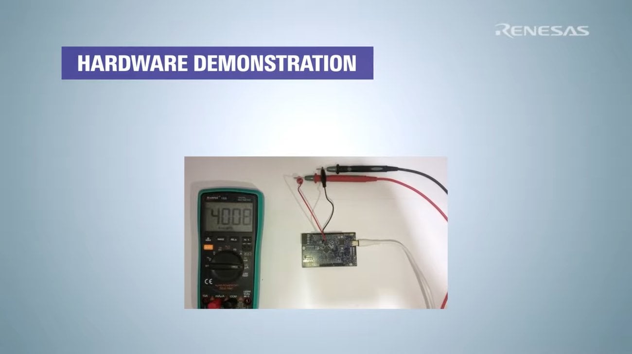

Step 8: Build and Measure
- Build the project and flash it to the evaluation board.
- Connect your multimeter in series with the board to measure current. Physical measurement is the only way to prove the hardware actually achieved microamp sleep states.

// Calculate the exact number of counts required for a 15-second sleep
period_counts = time_to_wake * info.clock_frequency;
// Stop the timer, update its period, and restart counting
R_TML_Stop(&g_timer0_ctrl);
R_TML_PeriodSet(&g_timer0_ctrl, period_counts);
R_TML_Start(&g_timer0_ctrl);
// Transition the MCU into Software Standby mode
R_LPM_LowPowerModeEnter(&g_lpm0_ctrl);
// Execution pauses here. The MCU will wake up on the timer interrupt.

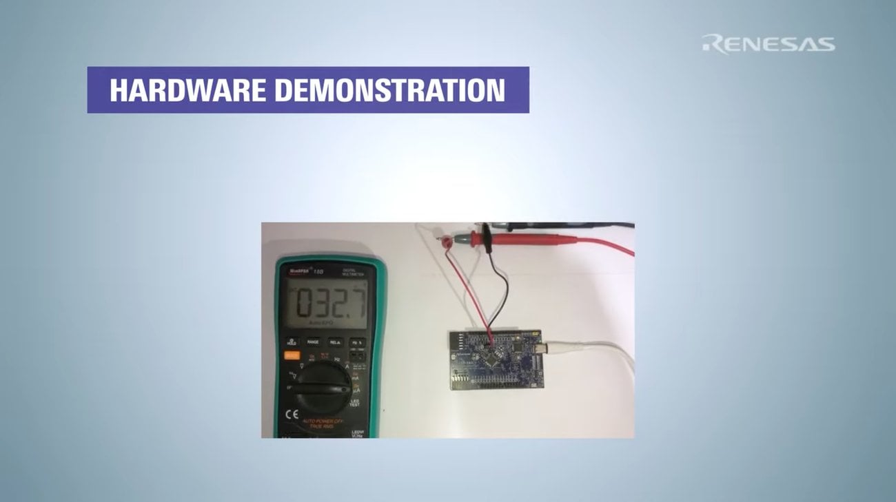

What You Should See
When the board is actively blinking its LEDs, your ammeter will read approximately 4.0 mA, indicating normal execution. After the blinking sequence finishes, the LEDs will turn off, and the current draw will drop drastically to roughly 32 µA as the board enters Software Standby mode. Exactly 15 seconds later, the current spikes back to 4 mA, and the LEDs will resume blinking.
Multimeter reading of approximately 32 µA during Software Standby mode. Image courtesy of Renesas.
