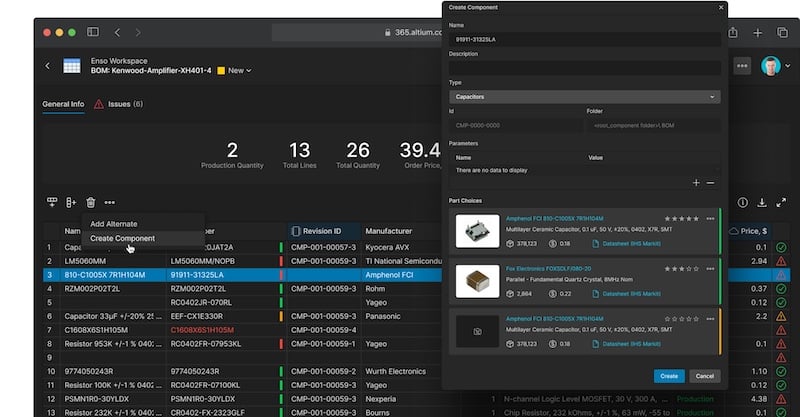

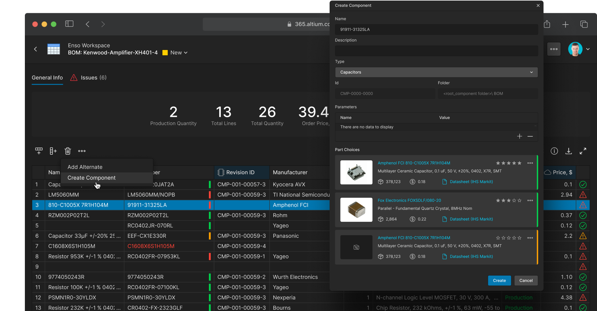

To help mitigate this, Altium’s BOM management capabilities (Figure 3) allow hardware teams to quickly source, compare, and lock down the right memory components early in the design process. This is critical for avoiding costly delays due to AI-driven part volatility.
Altium’s 365 BOM management capabilities help teams source and securememory components early.
Figure 3. Altium’s 365 BOM management capabilities help teams source and secure memory components early. (Click on image to enlarge)
