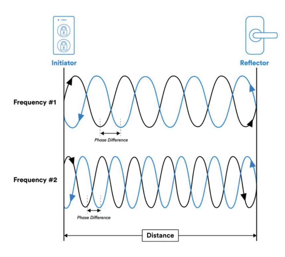

Phase-Based Ranging
Phase-based ranging (PBR) uses an Initiator and a Reflector to perform distance ranging (Figure 2). The Initiator sends a signal of a known frequency, which is then returned by the Reflector. The phase difference between the transmitted and received signal is measured.
Demonstration of phase-based ranging signals
Figure 2. Phase-based ranging uses phase differences between signals at two different frequencies to determine the distance between an Initiator and a Reflector. Image used courtesy of the Bluetooth SIG [click to enlarge]
The process is then repeated using a signal of a different frequency. With knowledge of the phase differences and the differences between the frequencies, a dedicated algorithm reveals the distance between the Initiator and the Reflector.

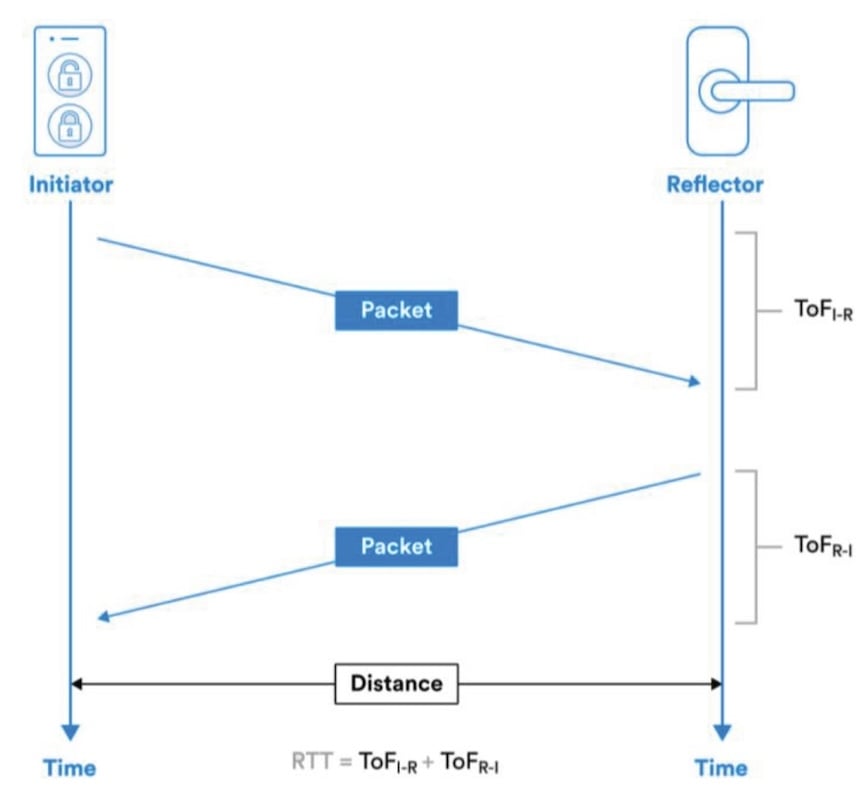

Round-Trip Timing
Round-trip timing (RTT) works by measuring the time it takes for a packet to travel between the Initiator and the Reflector and back, as illustrated in Figure 3. A known amount of time is subtracted from the overall time-of-flight to account for the time taken for the reflector to receive and then retransmit the packet. The distance is tehcn calculated by multiplying the round-trip flight time by the speed of light (c), and finally dividing by two.
Demonstration of round-trip timing signals
Figure 3. In round-trip timing, the time-of-flight of a radio packet between an Initiator and a Reflector can be used to determine the distance between the devices. Image used courtesy of the Bluetooth SIG [click to enlarge]
RTT acts as a secure distance bounding technique to cross-check PBR. The algorithms used for RTT to calculate the distance are simpler than those used for PBR.

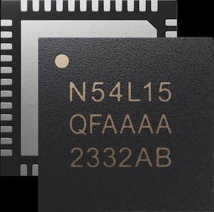

Nordic’s fourth-generation wireless SoCs, the nRF54L and nRF54H series, support Bluetooth 6.0 and Channel Sounding. Development support for the nRF54 Series is provided by Nordic’s unified and scalable software development kit, the nRF Connect SDK.
Nordic Semiconductor nRF54L15 system-on-chip package
Figure 4. The nRF54L15 fourth-generation wireless SoC supports Bluetooth LE, Mesh, and Channel Sounding. Image used courtesy of Nordic Semiconductor
While Bluetooth Channel Sounding will provide a good basis for PBR- and RTT-based proximity and distance-ranging applications, there is a proprietary alternative. The Nordic Distance Toolbox (NDT) offers PBR and RTT-based advanced distance measurements and proximity sensing capabilities for developers that need these capabilities outside the Bluetooth ecosystem or would like to implement related applications on selected Nordic nRF52 and nRF53 Series SoCs.
The accompanying software library for the nRF Connect SDK includes an algorithm that accurately determines the distance between two NDT-enabled devices, significantly enhancing accuracy compared to solutions based solely on the received signal strength indicator (RSSI). There is a sample in the nRF Connect SDK that demonstrates the functionality of NDT.
