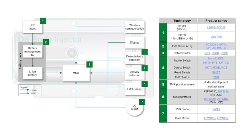

Figure 3, meanwhile, provides a more detailed block diagram of the same system, mapping specific circuit functions (for example, USB input, dose delivery sensing, activity detection) to the corresponding protection and control components. A reference table adjacent to the diagram outlines recommended solutions for each block—such as PPTC resettable fuses for USB-A/B ports, eFuse ICs for USB-C, and TVS diodes for motor and ESD protection.
Figure 3. Wearable medicine injector block diagram.
Figure 3. Wearable medicine injector block diagram. (Click on image to enlarge)

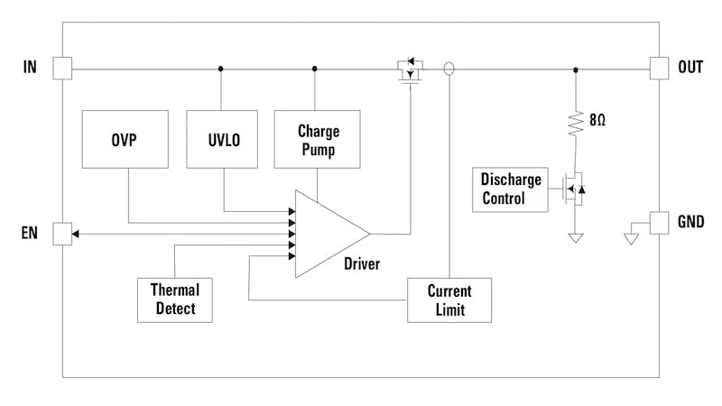

For designs using USB-C, engineers can implement a compact eFuse IC that integrates overvoltage, overcurrent, and overtemperature protection in one 4-pin DFN package. Figure 4 shows the block diagram of the LS0504EDD12, a Littelfuse eFuse Load Switch rated for 5.5 V and 4 A. The device includes a soft-start circuit to minimize inrush, an undervoltage lockout to protect against brownouts, and a 26 mΩ low RDS(on) internal switch to reduce conduction losses. This compact IC eliminates the need for multiple discrete protection components.
Figure 4. Low-RON eFuse 5.5 V, 4 A load switch (LS0504EDD12)

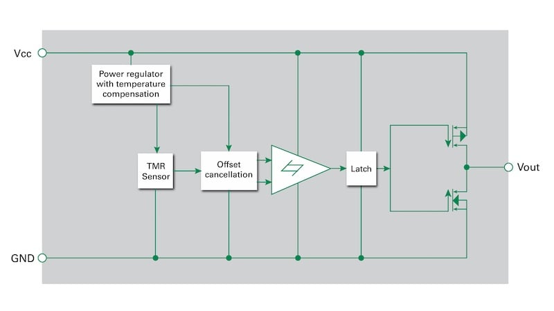

TMR Technology
A more advanced solution is the TMR (Tunneling Magnetoresistance) switch, shown in Figure 5. These switches use a magnetically sensitive junction to trigger a CMOS logic-level output. TMR switches like the one illustrated draw just 200 nA and can detect fields as low as 5 Gauss—ideal for monitoring the motion of the plunger in wearable injectors.
Integrated switch with tunneling magnetoresistance sensor and drive circuitry (courtesy of Littelfuse)
Figure 5. Integrated switch with tunneling magnetoresistance sensor and drive circuitry.
Placed near the bottom of the plunger chamber, the TMR switch responds as a magnet, mounted to the plunger, approaches. The microcontroller interprets the output voltage change to calculate the injection volume in real-time. This solution offers unmatched energy efficiency and precision.

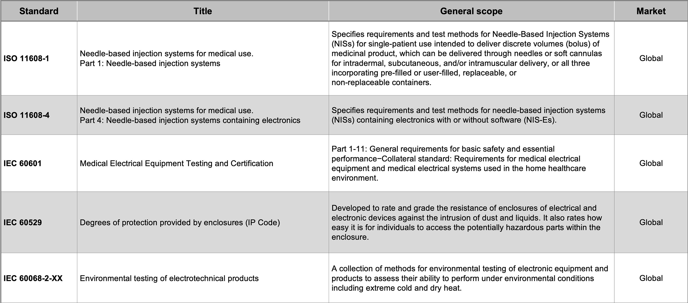

Standards Compliance
All wearable medical injectors must meet stringent safety and performance standards. Table 1 summarizes key regulatory standards relevant to wearable injectors.
Table 1. Applicable standards for wearable medicine injectors.
Table 1. Applicable standards for wearable medicine injectors. (Click on image to enlarge)
Early planning for certification—and partnering with vendors that offer pre-compliance support—can reduce redesigns and avoid delays during formal testing.
