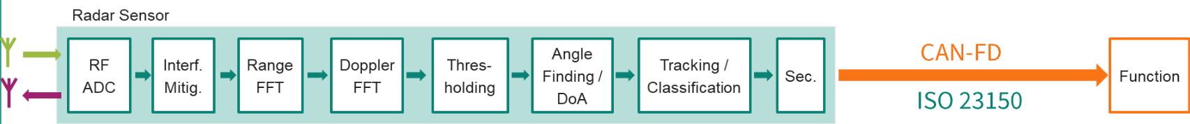

In current vehicle designs, radar signal processing is decentralized, with each module handling its own data at the edge using a specialized microcontroller that balances high performance against low cost and power. Dedicated hardware accelerators execute the range, Doppler, and angle fast Fourier transforms (FFTs), after which higher-level algorithms handle object detection, classification, and tracking. What leaves the module is an object list or limited point cloud, transmitted to the ADAS ECU over a low-bandwidth interface such as CAN-FD or 100 Mb/s Ethernet.
Figure 1. Edge-based sensor delivering object list information. Image used courtesy of Infineon

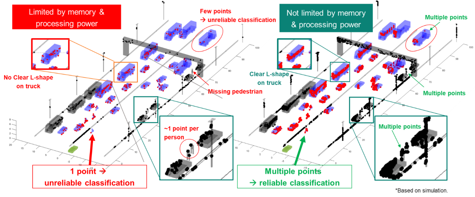

Another limitation is architectural. Because each radar unit processes independently and emits an abstracted object list, true sensor fusion is precluded before the data reaches the ECU. The result is a performance plateau dictated by strict cost and thermal envelopes, one in which radar point clouds lack the density and precision found in LiDAR or vision-based systems.
Figure 2. Point cloud density on the same simulated scenario: edge processing (left) versus central processing (right). Image used courtesy of Infineon

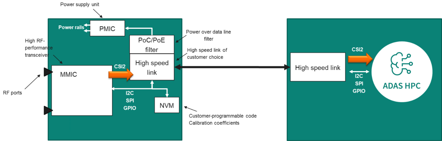

The alternative is to strip the radar sensor down and move the compute. High-speed signal processing can be offloaded entirely by using a centralized raw analog-to-digital converter (ADC) architecture, leaving the edge node with a millimeter-wave (mmWave) MMIC for RF transmission and reception, a lightweight housekeeping MCU for configuration, health monitoring, and basic control, a PMIC, and, where necessary, optional non-volatile memory that can hold calibration data and device-specific parameters.
Figure 3. Centralized radar architecture block diagram. Image used courtesy of Infineon
Raw ADC samples stream from the satellite sensor to the central ADAS ECU over a high-speed asymmetric link, using either of two options: SERDES, already a high-volume standard in automotive cameras, or asymmetric Ethernet, now being standardized and adopted. This low-power approach carries power and data over a single coaxial or Ethernet cable. Power-over-Coax or Power-over-Ethernet delivery is managed by a dedicated PMIC that ensures stable voltage regulation and electromagnetic compliance, reducing wiring harness complexity and vehicle weight. At the receiving end, a deserializer or asymmetric Ethernet interface based on the emerging IEEE 802.3dm asymmetrical automotive Ethernet standard reconstructs the stream for the central processor, while control commands and configuration updates flow bidirectionally across the same link, supporting over-the-air (OTA) updates and calibration.

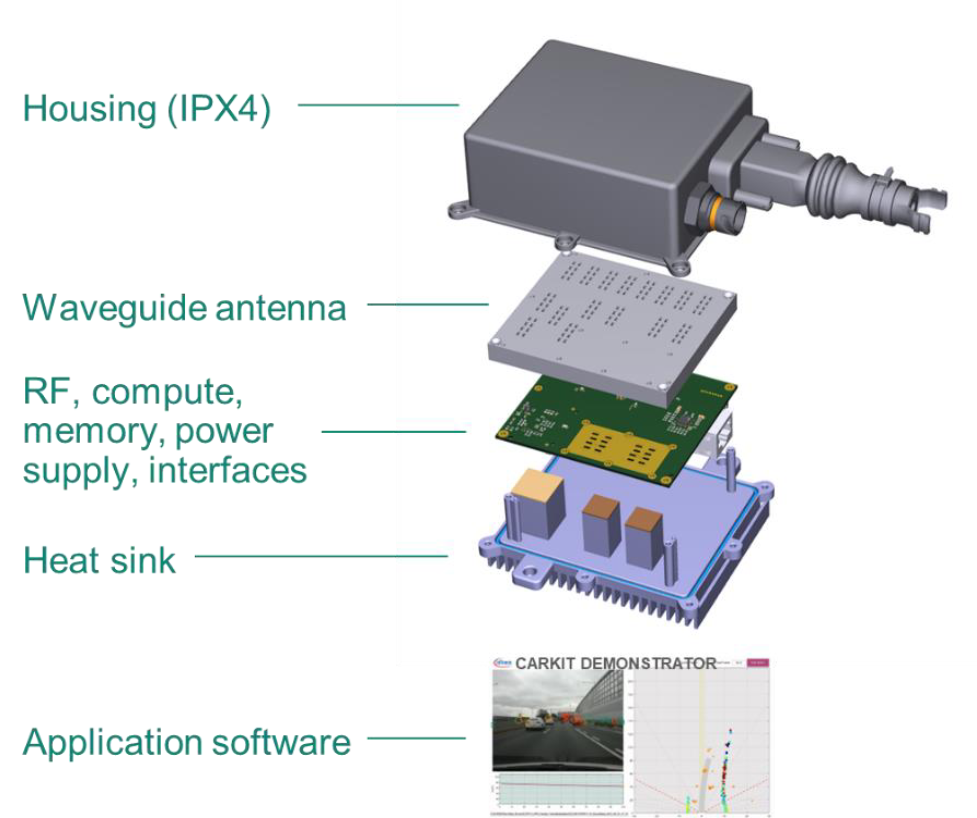

To help engineers prototype centralized systems, Infineon offers the CARKIT 8T8R CENTR, a vehicle-ready 77 GHz 8Tx8Rx radar module built for centralized architecture development. Instead of producing an on-sensor point cloud, it streams full raw ADC data at 5 Gb/s over coax cables up to 15 m long to a central compute unit, using either a MIPI A-PHY or a GMSL2 serializer, with power over coax. For teams that keep processing at the sensor, the companion CARKIT 8T8R EDGE runs radar signal processing on an AURIX microcontroller and outputs a processed point cloud over CAN or Ethernet.
Figure 4. Infineon Carkit supports the centralized radar processing approach. Image used courtesy of Infineon

Working from the complete raw data set, the central processor separates objects that edge nodes merge into a single blob, such as two vehicles side by side, a pedestrian beside a parked car, a cyclist overtaking traffic, or a guardrail that must be told apart from a stopped vehicle. The higher angular and range resolution behind that separation also reduces target ambiguity and minimizes ghost detections in urban environments and dense highway traffic.
