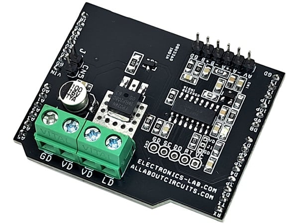

The Kilo Lamp is an interactive lamp controller built using an Arduino Uno shield. It also contains a load cell, a load cell amplifier, and a MOSFET that drives an LED using a pulse-width modulated (PWM) signal. The brightness of the LED is determined by how much weight is placed on the lamp. When the load reaches 5 kg, the lamp achieves 100% brightness. Figure 1 shows the fully assembled Kilo Lamp shield.
The Kilo Lamp shield.
Figure 1. The Kilo Lamp shield.

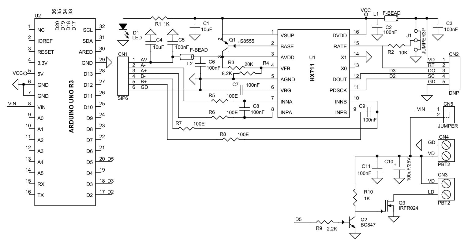

Schematic and Bill of Materials
Figure 2 provides the schematic for this project. You can view a higher-resolution version of the schematic by clicking on the image.
Schematic for the Kilo Lamp.
Figure 2. [click to enlarge] Schematic for the Kilo Lamp.

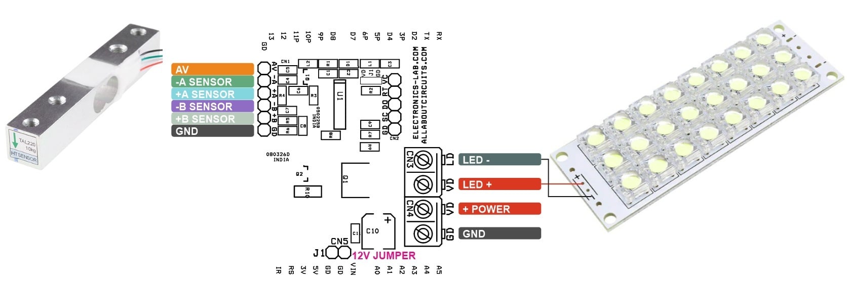

Wiring Instructions
To wire up the Kilo Lamp, consult the diagram in Figure 3 and the information below it.
How to connect up the Kilo Lamp.
Figure 3. [click to enlarge] How to connect up the Kilo Lamp. Image of load cell (left) used courtesy of SparkFun Electronics; Image of LEDs (right) used courtesy of ThinkRobotics
Referring back to the schematic in Figure 2, the wiring connections are as follows:
  • CN1
    • Pin 1 = Load Cell Red Wire.
    • Pin 2 = Load Cell Green Wire.
    • Pin 3 = Load Cell White Wire.
    • Pin 4 = No Use.
    • Pin 5 = No Use.
    • Pin 6 = GND.
  • CN2: Do Not Install.
  • CN5: Jumper for single supply operations.
    • Arduino Uno Vin and Shield 12 V.
  • CN3:
    • Pin 1 = VDD 12 V.
    • Pin 2 = LED Cathode.
  • CN4:
    • Pin 1 = GND.
    • Pin 2 = 12 V DC Input.

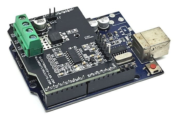

Upload this code to the Arduino Uno and install the shield (Figure 4) to see the magic!
The completed Kilo Lamp project with the shield installed.
Figure 4. The completed Kilo Lamp project with the shield installed.
