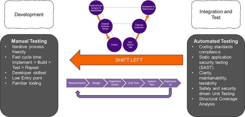

RISC-V offers many advantages for customization for a “shift left” in the development process.
Figure 1. RISC-V offers many advantages for customization for a “shift left” in the development process.
This article discusses RISC-V features that provide architectural-level options and support software verification tools for critical applications in the automotive, aerospace, industrial control systems, and similar sectors. Embedded systems teams can use these capabilities to reduce security risks and promote DevSecOps practices as early as possible in the development lifecycle.

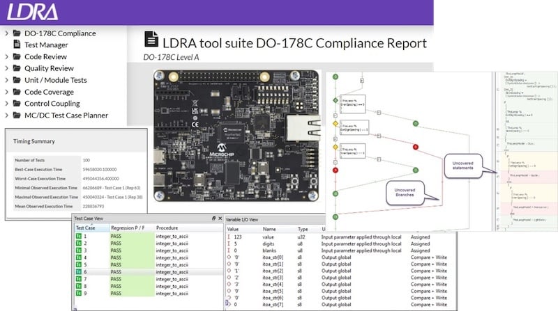

Many software development tools for RISC-V support security-focused development practices. Advanced toolsets, such as LDRA's target license package (TLP) for RISC-V architectures, support requirements traceability, coding standards compliance, vulnerability detection, and multi-core code coverage analysis on the development host and target. Additionally, LDRA is highly integrated with RISC-V environments, supporting dynamic testing with silicon-level simulation and real hardware.
LDRA’s tool suite provides a variety of resources for analyzing code and ensuring compliance to standards and certifications.
Figure 2. LDRA’s tool suite provides a variety of resources for analyzing code and ensuring compliance to standards and certifications.
