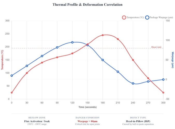

Dynamic Package Warpage During Reflow
The most insidious threat is the Coefficient of Thermal Expansion (CTE) Mismatch. The silicon die, organic substrate, and FR-4 PCB expand at different rates.
During the time that the assembly is passing through the reflow oven, the SoC package adjusts its shape in a dynamic manner.
  1. Transition Zone (150°C - 190°C): The organic substrate is growing at a rate quicker than that of the silicon die, which is resulting in the corners being curled downward ("Frown").
  2. Peak Zone (>217°C): The warpage may invert or relax. If the corners lift by tens of microns (often exceeding package or JEDEC-defined limits) while the solder is molten, the ball separates from the paste. Upon cooling, it drops back down on frozen flux, failing to form a bond.

Head-in-Pillow (HiP)
Head-in-Pillow is one of the most characteristic defects of SoC assembly. It occurs when the BGA sphere and solder paste melt individually but fail to coalesce.
Mechanism: Warpage lifts the ball off the paste during the soak zone. The exposed surfaces oxidize rapidly. When the package settles, the oxidation layer prevents mixing, creating a contact that passes DC electrical testing but fails under mechanical stress.

Graph correlating SoC package dynamic warpage with reflow temperaturezones, identifying the risk window for Head-in-Pillow defects.
Figure 2. Graph correlating SoC package dynamic warpage with reflow temperature zones, identifying the risk window for Head-in-Pillow defects.
