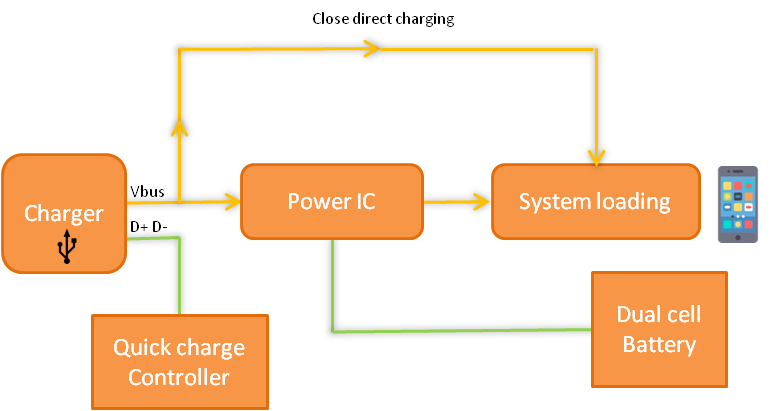

The O-brand SuperVOOC works by exploiting low voltage and large current as well as the new voltage charging algorithm, a direct charging method that achieves constant voltage and current control dynamically at the adapter. In the large current charging mode, the charger charges the battery directly through the direct charging switch. The dual cells are in series for greater charging voltage.
The open-voltage loop realizes the output constant current in stages. The “open voltage loop” is a device designed based on the principle of negative feedback and its main function is to control the voltage and current during battery charging. As the charging current exceeds the predefined threshold, the open-voltage loop opens the switch in the circuit automatically to reduce the battery voltage while maintaining constant charging current.
The charging method achieves constant-current output in stages. It is effective in improving charging efficiency and safety and, therefore, the charging power at the end up to 125 W (20 V / 7.5 A). Figure 2 illustrates the principle behind the O-brand SuperVOOC.
Fast charging principle behind O-brand SuperVOOC
Figure 2. Fast charging principle behind O-brand SuperVOOC
