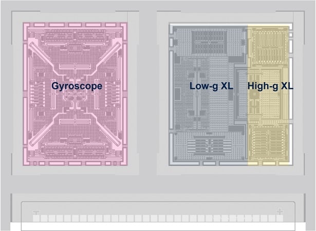

An Innovative Solution
A new sensor technology from ST could potentially solve these problems. Using a novel MEMS mechanical structure, it’s designed to accurately and efficiently measure both high and low acceleration levels within a single integrated solution. The structure houses a gyroscope and two accelerometers—one up to 16 g and the other above 80 g—within a standard package, optimizing space and simplifying system design.
The mechanical structure of the LSM6DSV80X houses two accelerometers.
The mechanical structure of ST’s LSM6DSV80X inertial measurement unit houses two accelerometers: one up to 16 g (low-g XL) and the other above 80 g (high-g XL).

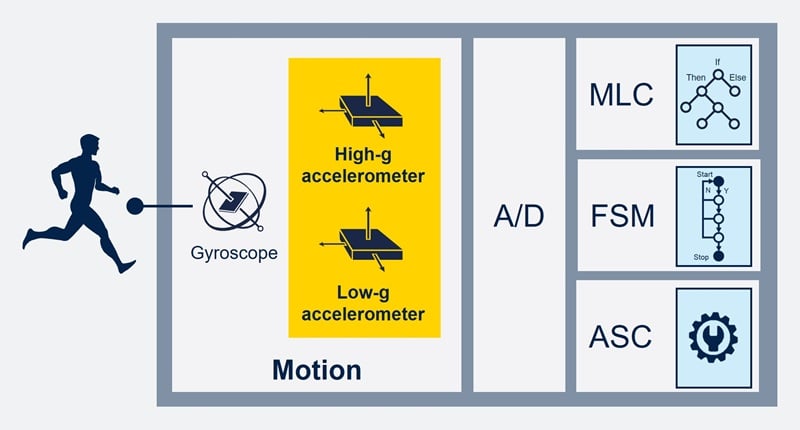

The digital component of this inertial measurement unit (IMU) sensor eliminates the need for constant intervention from the host processor. Its advanced capabilities include:
  • Edge processing, including a finite state machine (FSM) and a machine learning core (MLC).
  • Sensor fusion.
  • Adaptive self-configuration (ASC).
The IMU features edge processing along with two accelerometers and a gyroscope.
Together, the innovations listed above help the sensor perform consistently and deliver valuable insights about standard motion and impact events. In addition to enhancing the accuracy and range of acceleration measurements, this design also significantly minimizes system power consumption, making it a good choice for a wide array of applications.

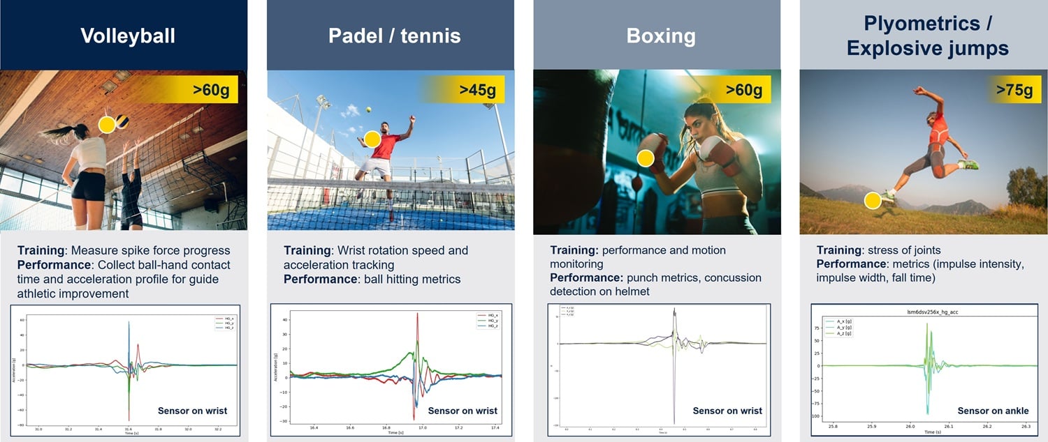

Athletics
Athletes, both professional and amateur, use wearables with high-impact sensors to track performance and detect injuries. These wearables help them to optimize their training and prevent long-term damage.
Sensors embedded in helmets, for example, monitor and record impacts. By providing real-time data on the force of those impacts, they help to prevent concussions and other head injuries. A few more use cases are provided below.
Some sports-centric use cases for wearable IMUs.
Some sports-centric use cases for wearable IMUs. [click to enlarge]
