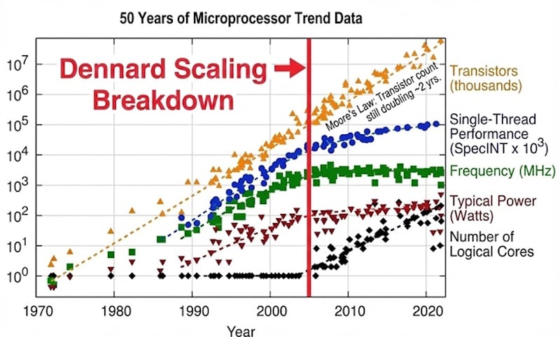

The Breakdown of Dennard Scaling: Physical Limits in the Deep Sub-Micron technology
Dennard’s Scaling theory postulated that the internal electric fields would remain constant if the channel length, width, oxide thickness, and the supply voltage were lowered by a factor k, while increasing the substrate doping by the same factor. This 'constant field’ established a scaling trajectory: power density remained invariant, while switching speed, drive current, and transistor density improved generation after generation [1]. This relationship became the engine behind the industry’s exponential progress, enabling the doubling of transistor density famously predicted by Moore.
In the deep sub-micron era (below 0.25 um), physical limits increasingly constrained further reductions in threshold voltage and gate-oxide thickness. Lowering the threshold voltage caused massive leakage current, while making the oxide thickness thinner than 1.5 nm made electrons tunnel straight through the gate. So, the supply voltage could not be reduced enough, causing dangerously high electric fields.
When the channel length became comparable to the source and drain depletion regions, the old rules failed, and scaling trends indicate that deep-nanometer devices face increasingly severe electrostatic constraints [2]. Figure 1 describes the microprocessor scaling trends, illustrating the breakdown of Dennard scaling and its impact on performance, frequency, and power consumption.
![Figure 1. Microprocessor scaling trends [2].](https://www.allaboutcircuits.com/uploads/articles/Si-Vision_Nanoscale_Fig_1.jpg)

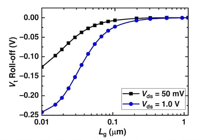

Threshold Voltage Roll-off
In long-channel devices, Vth is independent of channel length. However, as Lg decreases, a significant fraction of the bulk charge under the gate is supported by the depletion fields of the source and drain, and Vth is reduced as depicted in Figure 3 [3].
![Figure 3. Threshold Voltage Roll-Off vs. Gate Length at different Vds
voltages [3].](https://www.allaboutcircuits.com/uploads/articles/Si-Vision_Nanoscale_Fig_3.jpg)
Figure 3. Threshold Voltage Roll-Off vs. Gate Length at different Vds voltages [3].

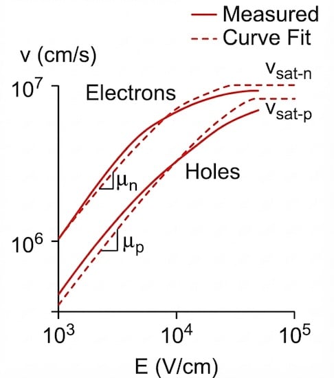

Velocity Saturation
Velocity saturation and quasi-ballistic transport effects change how short-channel devices behave when they are ON. The short-channel electric field becomes so strong that carriers reach a maximum velocity Vsat. The quadratic law, \(I_{ds} \propto (V_{gs} - V{th})^2\), is no longer valid for short-channel devices. Instead, carrier velocity saturation limits the drain current by transport velocity rather than mobility, as illustrated in Figure 5.
![Figure 5: Velocity saturation for holes and electrons [6].](https://www.allaboutcircuits.com/uploads/articles/Si-Vision_Nanoscale_Fig_5.jpg)
Figure 5. Velocity saturation for holes and electrons [6].

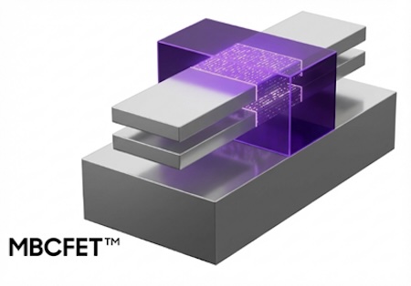

Samsung SF2: Multi-Bridge Channel FET (MBCFET)
Samsung led the industry implementation of GAA and introduced its MBCFET technology at the 3 nm node, with SF2 representing a second-generation refinement that enables fine-grained SCE optimization beyond FinFET capabilities [11]. The SF2 architecture emphasizes inner spacer engineering, a critical isolation layer between the source/drain extensions and gate stack, to improve electrostatic control. Optimized low-k inner spacers reduce parasitic overlap capacitances and suppress GIDL and punch-through paths [11, 13].
Additionally, MBCFET offers finer effective width granularity than fin-count–quantized FinFETs by allowing adjustable nanosheet geometries within process design-rule limits, enabling more targeted drive current sizing with reduced over-sizing penalties [12]. Figure 6 depicts the MBCFET structure.
![Figure 6. The MBCFET Structure [11].](https://www.allaboutcircuits.com/uploads/articles/Si-Vision_Nanoscale_Fig_6.jpg)

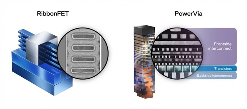

Intel 18A: RibbonFET and PowerVia
Intel’s 18A node combines RibbonFET gate-all-around transistors with backside power delivery to address scaling limitations in electrostatic control and interconnect routing. As shown in Figure 7, RibbonFET employs vertically stacked nanosheet channels to increase effective channel width per footprint while enabling full gate enclosure, improving subthreshold swing to reported values on the order of ~65 mV/dec and reducing drain-induced barrier lowering through enhanced electrostatic shielding [14, 15].
In parallel, the PowerVia backside power delivery network relocates high-current power rails from front-side metal layers to the wafer backside, reducing routing congestion, improving signal integrity, and lowering resistive voltage drop. This vertical power delivery approach enables density scaling through reduced cell height rather than aggressive gate pitch shrinkage, preserving critical gate length and spacer dimensions required for short-channel effect suppression while meeting advanced-node area targets [16, 17].
![Figure 7. The RibbonFET transistor and the PowerVia backside
power-delivery [14].](https://www.allaboutcircuits.com/uploads/articles/Si-Vision_Nanoscale_Fig_7.jpg)
Figure 7. The RibbonFET transistor and the PowerVia backside power-delivery [14].
