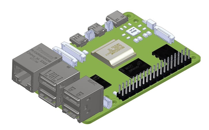

Step 1: Model the PCB and Internal Components
Start by creating a 3D model of all the internal components and the PCB that will be housed in the enclosure (Figure 1). Usually manufacturers have downloadable 3D files and drawings for their components. Creating the 3D model of the internal components makes it easier to design the right-sized enclosure and check for any physical interferences later.
3D model of a Raspberry Pi 5 board
Figure 1. 3D model of a Raspberry Pi 5 board
