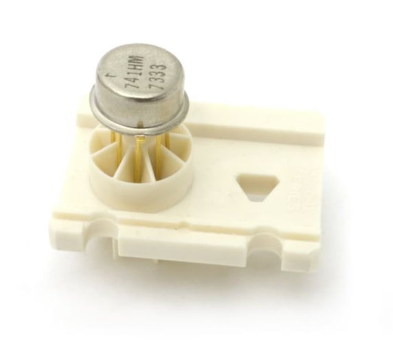

Fairchild's µA741 op amp
Fairchild's µA741 op amp. Image used courtesy of Mark Richards via the Computer History Museum
Still, in ±12-V or ±15-V analog domains, where bandwidth is modest and power isn’t mission-critical, the 741 can still be the right tool, especially when ease of use matters more than performance. And it lives on in CMOS variants, hobbyist kits, and retro analog gear.
