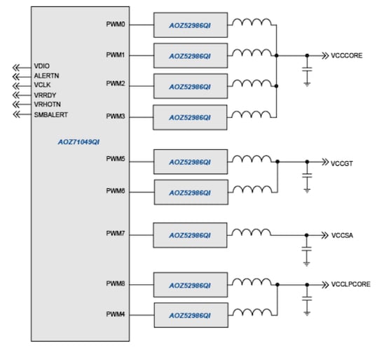

Enabling this is AOS's proprietary Advanced Transient Modulation (A2TM) technology. A2TM uses a variable-frequency hysteretic peak-current mode control scheme with advanced phase-current sensing, a hybrid approach that AOS describes as combining digital flexibility with analog efficiency. Where a purely digital controller relies on firmware-driven loop compensation, A2TM's analog control loop provides inherently faster response to load transients while the digital layer handles configuration, telemetry, and communication with the platform over the SVID interface.
Block diagram of the AOZ71049QI.
The result is an ultra-fast transient response with tight current balancing across phases, both during transient events and under steady-state DC loads. This is particularly important for modern mobile SoCs that experience frequent, rapid voltage transitions between power states. The controllers handle these transitions while maintaining the low quiescent current that extends battery life during idle and light-load conditions.
All three controllers communicate over a single SVID interface, managing five separate domains and supporting programmable switching frequencies from 300 kHz to 1.8 MHz with 0.5% output-voltage accuracy via differential remote sensing. Multi-time programmable memory with GUI-based configuration eliminates manual solder rework during tuning and reduces bill-of-materials complexity. Built-in acoustic noise suppression addresses audible coil whine under varying loads, a persistent nuisance in thin notebook designs.

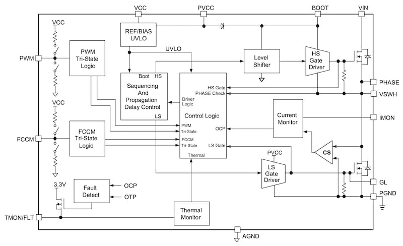

AOS is pairing the new controllers with the AOZ52986QI Smart Power Stage, a compact 3 mm x 4 mm QFN package that integrates driver and MOSFET functions. The SPS supports a 2.7-V to 22-V supply range with a 30-V high-side MOSFET, delivers 45 A of continuous output current with peaks up to 80 A, and can switch at frequencies up to 1.5 MHz.
A symmetrical pinout simplifies PCB layout and reduces parasitic inductance by 5% compared to previous-generation designs, which is critical for maintaining clean voltage transitions at high switching frequencies, particularly in tightly packed notebook board layouts. The higher switching frequency also allows designers to use smaller external inductors and capacitors, reducing the footprint of the power delivery network.
Typical application of the AOZ52986QI.
The SPS integrates current monitoring at 3.5% accuracy and temperature monitoring at 2% accuracy, providing the controller with the telemetry it needs for autonomous phase shedding, overcurrent protection, and thermal management. Integrated sensing eliminates the need for external current-sense resistors, further simplifying the power stage design.
