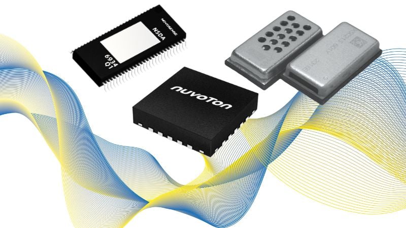

With the goal of improving the efficiency, utility, and performance of audio systems, several companies have recently released new devices to overcome key challenges in the audio electronics industry. While these new products take many forms—from class D amplifiers to solid-state speakers—they provide designers with tools to make audio devices smaller and easier to use.

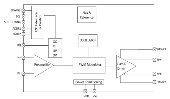

Nuvoton has also released a new class D amplifier targeting consumer electronics. Consumer electronics, such as Bluetooth speakers or wireless doorbells, must use their limited stored energy in the most efficient way possible. Nuvoton designed its new amplifier chip to improve the user experience and reduce the frequency of charging while simultaneously improving performance.
The Nuvoton class D amplifier
The Nuvoton class D amplifier integrates many of the necessary components on-chip, allowing denser integration in small audio devices such as speakers or handheld tablets. Image used courtesy of Nuvoton
The NAU82110YG (datasheet linked) offers improved SNR performance, with a reported 103 dB SNR, ensuring that, even at high gains, noise does not become an issue. Furthermore, the low quiescent current of 6 mA at 12 V input helps to preserve power. The chip can provide up to 18 W of power to a 4-Ω load and features a 4.6-ms startup time in addition to numerous safety features.
