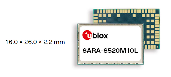

U-blox has recently introduced its first multi-mode cellular and satellite IoT module, the SARA-S520M10L. Based on the U-blox UBX-S52 chipset, this module is designed for ORBCOMM satellite connectivity and cellular terrestrial networks. It's also the first U-blox cellular module compliant with the ORBCOMM IDP protocol.
The u-blox SARA-S520M10L
The U-blox SARA-S520M10L. Image used courtesy of U-blox
With dimensions of 16.0 x 26.0 x 2.2 mm and a weight of less than 3 grams, the SARA-S520M10L’s 96-pin LGA footprint is designed for compactness without compromising on functionality. For low-power operation, the device features an ultra-low power-saving mode (PSM) current consumption of just 1 µA and an extended discontinuous reception (eDRX) mode current consumption of 180 µA. The LTE Cat M1 and Cat NB2 offer a connected mode current consumption of 195 mA and 135 mA at 23 dBm, respectively.
In terms of data rates, the module supports LTE Cat M1 with 588 kb/s download and 1200 kb/s upload speeds and LTE Cat NB2 with 125 kb/s download and 140 kb/s upload speeds. It employs the IDP satellite protocol and operates in the L-band with a satellite power class of 33 dBm.

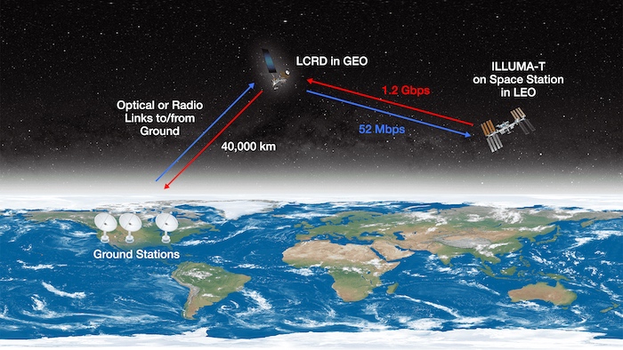

NASA recently announced that starting in 2023, the organization will be demonstrating its first end-to-end laser relay system.
Specifically, NASA will be launching the Integrated LCRD Low Earth Orbit User Modem and Amplifier Terminal (ILLUMA-T) to the International Space Station (ISS). Working in conjunction with the Laser Communications Relay Demonstration (LCRD), which was launched in 2021, ILLUMA-T will form a laser-based optical link to facilitate higher data rate communication with earth. Communicating directly with the LCRD, ILLUMA-T will support data transmission at a rate of 1.244 Gbps and data download at a rate of 52 Mbps. The LCRD will then relay the communication directly back to Earth.
Working principle of the ILLUMA-T communication systems
Working principle of the ILLUMA-T communication systems. Image used courtesy of NASA
According to NASA, laser communications will be used to transmit images and videos back to Earth. With faster data rates and less power consumption than conventional satellite communications, NASA designed the laser-based system to revolutionize space communications.
