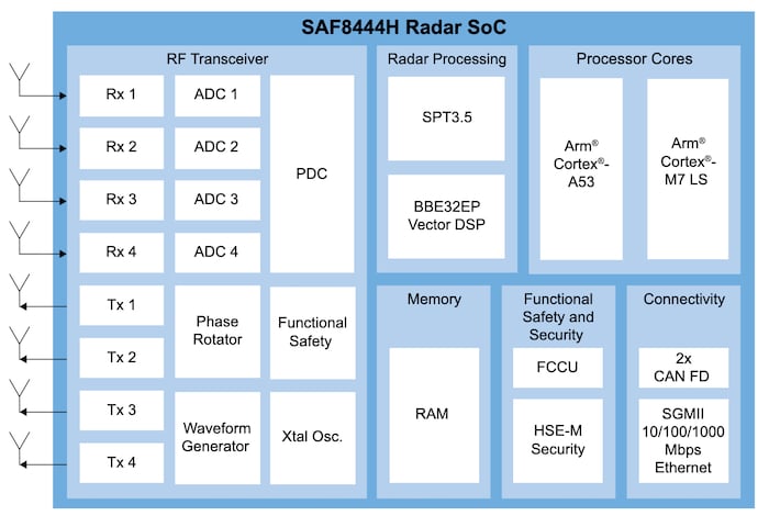

Block diagram of the SAF8444H
Block diagram of the SAF8444H. Image used courtesy of NXP
Currently, NXP offers the SAF8444 in two configurations. The SAF8444E variant pairs an Arm Cortex-M7 at 320 MHz with NXP's SPT 3.4 radar signal processor and an integrated BBE32 Vector DSP.  The SAF8444H option adds an Arm Cortex-A53 at 320 MHz and upgrades to SPT 3.5 for heavier perception workloads. Both variants include up to 4 MB of ECC-protected SRAM, dual CAN-FD ports, and SGMII Gigabit Ethernet at 10/100/1000 Mbit/s.

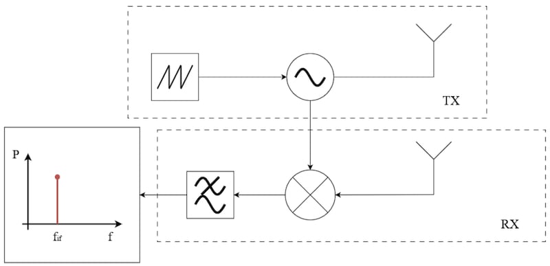

Basic scheme of an FMCW radar.
Basic scheme of an FMCW radar. Image used courtesy of MDPI
Chirp bandwidth is a major variable in this context. For frequency-modulated continuous wave (FMCW) radar, range resolution scales inversely with bandwidth. A 4-GHz chirp bandwidth, for example, corresponds to a theoretical range resolution of approximately 3.75 cm, enabling finer object discrimination in near-field and parking scenarios. Achieving this bandwidth in a power-efficient design, however, requires tight control over parasitic loading in the signal chain.
