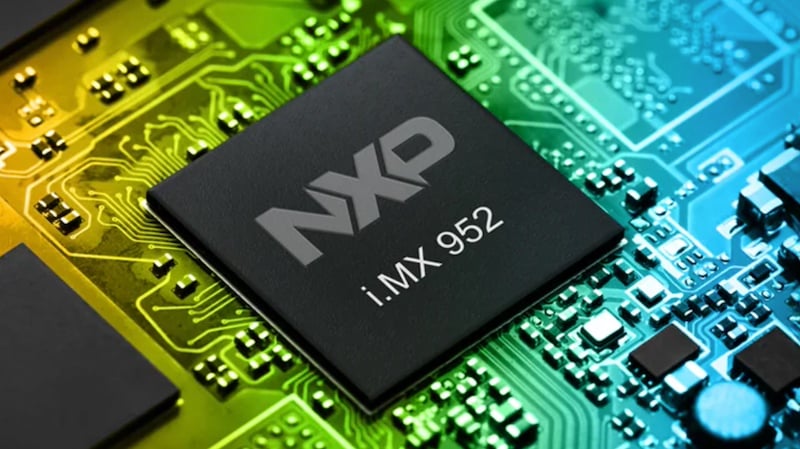

NXP Semiconductors has announced the i.MX 952 applications processor. An extension of its i.MX 9 series for AI-powered automotive interiors, the device integrates the company’s eIQ Neutron neural processing unit (NPU) to support driver monitoring, child presence detection, and adaptive vehicle interaction through on-device machine learning.
The i.MX 952 applications processor
The i.MX 952 applications processor. Image used courtesy of NXP
Compatible with existing i.MX 95 platforms, the i.MX 952 is said to empower developers to scale designs for various performance tiers while maintaining a consistent hardware and software foundation.
