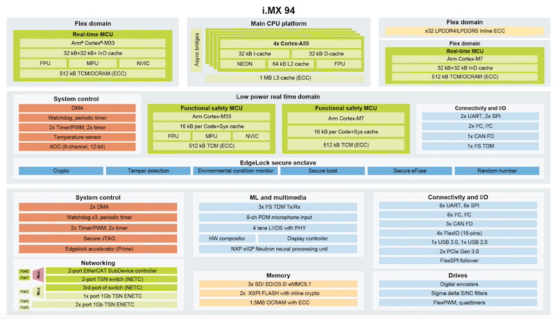

i.MX 94 family block diagram
i.MX 94 family block diagram.
For AI/ML compute, the i.MX 94 includes the NXP eIQ Neutron neural processing unit (NPU), which delivers 0.5 TOPS of machine learning performance. The NPU is supported by the eIQ development environment, which offers diverse machine learning frameworks that allow developers to implement custom AI models optimized for edge deployment.
