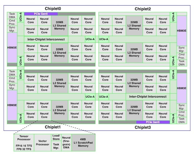

Rebellions designed the Rebel100 around that constraint. The part is a system-in-package that connects four homogeneous chiplets, each roughly 320 mm², via a UCIe interconnect. Across the package, Rebellions pairs 144 GB of HBM3E running at 4.8 TB/s with 512 MB of on-chip SRAM per die, and rates the device at about 2 PFLOPS of FP8 compute. At ISSCC 2026, the company described the part as the industry’s first quad-chiplet AI accelerator to use UCIe, and claimed H200-class performance within a lower power envelope.
The Rebel100 connects four chiplets over a UCIe interconnect in a single package. (Click on image to enlarge).
For Park, the packaging choice follows directly from how transformer inference behaves. “We are focused on a memory-centric architecture, backed by SK Hynix and Samsung Foundry,” said Park. “Memory and logic are combined into a single accelerator, because transformers require a lot of memory bandwidth.”
”We are designing a 3D-stacked IC where the memory sits right next to the logic, and we co-optimize the two together to enable the most efficient inference.”

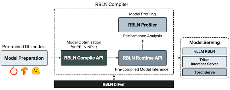

Hardware capacity means little without a software path that developers will actually adopt, and that path has historically run through Nvidia’s CUDA. Rebellions is taking the opposite route with its RBLN SDK, building on open components including vLLM, PyTorch, Triton, and Hugging Face rather than a proprietary stack.
Park frames the decision through a historical analogy. “Intel beat IBM not because its silicon was better, but because it embraced Linux while IBM stayed on Unix,” he said. “The same thing is happening now in inference. PyTorch 2.0 and torch.compile give us an abstraction layer over the hardware, so our customers don’t need to care what silicon is underneath. We sacrifice maybe 5 to 10 percent of performance for that, and we think it is worth it.”
The RBLN compiler
The RBLN compiler
