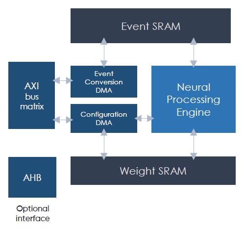

Akida Pico functional block diagram
Akida Pico functional block diagram.
At the heart of Akida Pico is a neural processing engine that employs a minimal core for temporal event-based neural networks (TENNs). TENNs were developed to address some limitations of traditional artificial neural networks (ANNs), such as convolutional neural networks (CNNs). CNNs are good at processing spatial information in images but are ineffective when processing temporal information or information that conveys the passage of time.
Operated in standalone mode, the Akida Pico can independently process audio and vital signs data at very low power levels to generate instant, personalized event triggers based on detected health anomalies (like high heart rate) or voice commands from a device’s owner through voice-activated systems.
As a co-processor, the Akida Pico allows engineers to offload otherwise intensive AI processing tasks from the system MCU/CPU to the application-specific and far more energy-efficient NPU. For continuous monitoring applications, it also offers a wake-up function for more power-hungry system processors, preserving power by filtering out false alarms and ensuring that only qualified events initiate a wake-up.

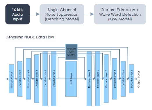

Akida Pico audio use case flow
Akida Pico audio use case flow.
The machine learning framework also converts quantized models trained using traditional deep-learning methods to event-domain models with low latency and power consumption. A hardware abstraction layer (HAL) within the platform-agnostic Akida Runtime executes models on Akida hardware. Akida Runtime also includes a software simulator for model evaluation without hardware.
