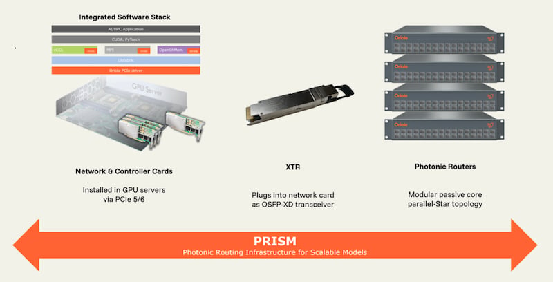

London startup Oriole Networks has announced the first commercial deployment of its PRISM photonic networking platform, installed at the U.K.'s ARIA Scaling Inference Lab, a $68 million-backed testbed. PRISM replaces the electronic switches at a network's core with nanosecond-scale optical circuit switching, moving data between chips as photons rather than electrical signals. Oriole's designs are xPU-agnostic.
PRISM
PRISM is a full-stack, all-optical fabric that quickly and simply connects GPUs at scale. Image used courtesy of Oriole
A spinout from University College London founded in 2023, Oriole has raised roughly $35 million. Running alongside AMD Instinct GPUs and EPYC CPUs, the system cuts core network power consumption by 81% and drops GPU idle time from about 60% today to under 1%, according to the company.
AMD is contributing GPU and CPU hardware and helping validate the fabric at frontier scale; Madhu Rangarajan, AMD's corporate vice president for Compute and Enterprise AI, called nanosecond optical circuit switching "a fundamentally different way to connect accelerators at scale." The deployment runs as part of a collaboration with AMD that has been underway for more than a year. The company plans a wider industry rollout in 2027.

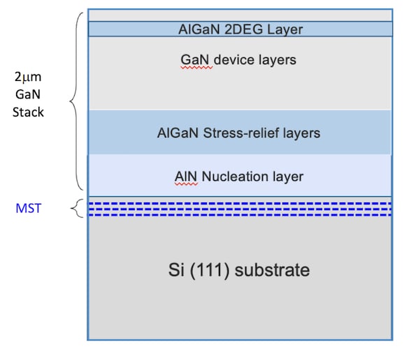

Silicon engineering company Atomera has announced a process to make gallium nitride (GaN) RF devices cheaper to build. High-performance RF GaN is usually grown on silicon carbide, which performs well but stays costly and hard to scale. GaN-on-silicon offers a lower-cost, more scalable base, yet parasitic channel charge at the device interface has historically held back its RF performance.
Schematic of RF GaN-on-Si wafer
Schematic of an RF GaN-on-Si wafer. Image used courtesy of Atomera
Atomera says its MST technology, an engineered film of silicon and oxygen inserted during fabrication, reduces parasitic channel charge by more than 10x while preserving linearity under power stress. Linearity is key because RF front ends must amplify signals without distorting them. The company says its test data shows devices handling significant power while holding signal quality.
That combination opens GaN-on-silicon to 5G, future 6G, and other high-frequency uses. With Atomera's MST removing barriers to GaN-on-silicon-based RF systems, the company is presenting a cheaper substrate stand-in for parts that have leaned on more expensive materials.
