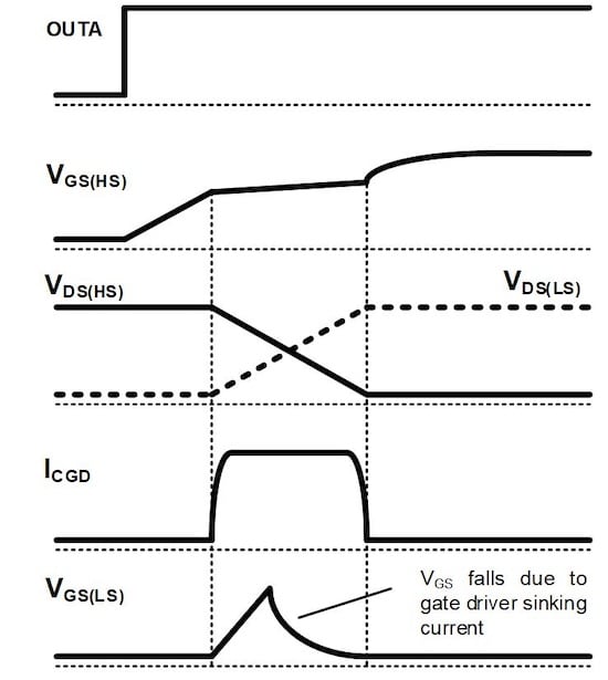

  1. When the high-side MOSFET (HS-FET) turns on, its drain-to-source voltage (VDS(HS)) drops (negative VDS(HS) slope) to practically 0 V.
  2. The drop in VDS(HS) causes the low-side MOSFET’s (LS-FET, acting as a diode) drain-to-source voltage (VDS(LS)) to increase with the same slope, but positively.
  3. The LS-FET’s slope (dVDS(LS)/dt) causes the gate-to-drain capacitance to charge (Miller effect), which generates a current displacement (ICGD). This is also called the Miller current.
  4. Most of the Miller current that is not drawn by the gate circuitry goes towards charging the input capacitance (CGS), thereby increasing the LS-FET’s gate-to-source voltage (VGS(LS)).

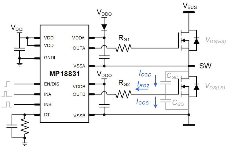

Figure 2 shows SiC MOSFETs in a half-bridge configuration driven by the MP18831 gate driver. In this figure, the Miller current’s path is highlighted in blue.
Figure 2. SiC MOSFETs in a half-bridge configuration.
Figure 3 shows this entire process. If ΔVGS(LS) exceeds the threshold voltage (VTH), then the LS-FET enters conduction as long as the gate voltage remains above the threshold, which causes shoot-through. The same is true for the opposing scenario, in which the LS-FET actively triggers and induces an undesired HS-FET turn-on.
Figure 3. Current and voltage waveforms.
Now we quantify the phenomenon to determine how likely it is to occur in our design. By applying Kirchhoff’s current law (KCL) at the LS-FET’s gate node, we can calculate the Miller current (denoted as ICGD in Figure 2) as:
$$I_{CGD} = I_{CGS} + I_{RG2}$$
Equation 1.
This equation can then be expanded to:
$$C_{GD} \times \frac{dV_{DG}}{dt} = C_{GS} \times \frac{dV_{GS}}{dt} + I_{RG2}$$
Equation 2.
For high-voltage systems (VBUS >> VGS), we can approximate VDG as approximately equal to VDS. Non-idealities such as gate loop inductance, internal FET gate resistance, or the gate driver IC’s saturation current modify the gate driver’s effective sink current (IRG2). This makes it difficult to determine how the gate driver contributes to ICGD.
For simplicity, we can assume that the gate driver is unable to sink any current fast enough to prevent CGS from being charged (which occurs when IRG2 ≈ 0 A). In this case, the voltage rise on the gate is the result of a capacitive voltage divider. The change in VGS can be calculated as follows:

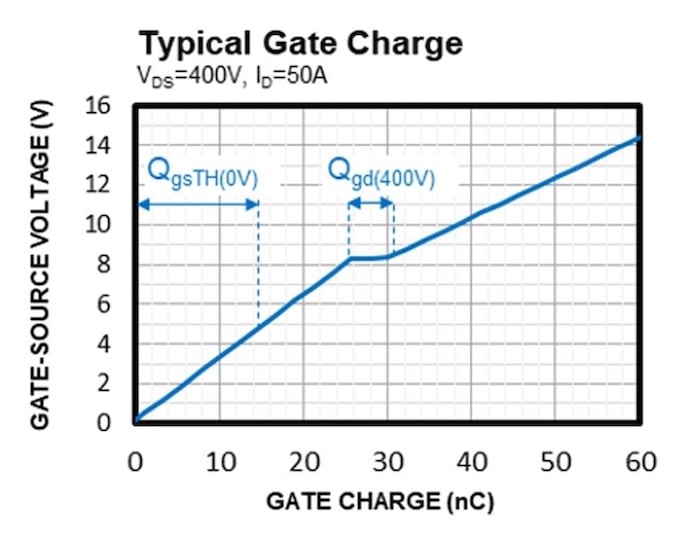

Obtaining the Miller Ratio from Datasheet Parameters
The gate charges that are indicated on the electrical characteristics chart are discrete (see Table 1). Note that these values are specific to the conditions listed below.
Table 1. Gate charge parameters in a SiC cascode datasheet.
Parameter Symbol Conditions Min Typ Max Units
Threshold gate-to-source charge QGS(TH) VDS = 400V, ID = 50A,
VGS = 0V to 12V
14
nC
Plateau gate-to-source charge QGS(PL)
26
nC
Gate-to-drain charge QGD
6
nC
Total gate charge QG
50
nC
The test conditions are set to be realistic for the final application (e.g., the usual bus voltages and recommended driving rails). A quick inspection of the chart values gives us an idea of the chosen transistor’s Miller ratio. If the final application differs from the test conditions, we can check the typical gate charge curve and linearly extrapolate the values for different voltage rails (see Figures 4 and 5).
Figure 4. Gate charge curve from the datasheet.
Figure 5. Gate charge curve with the extended axis values.

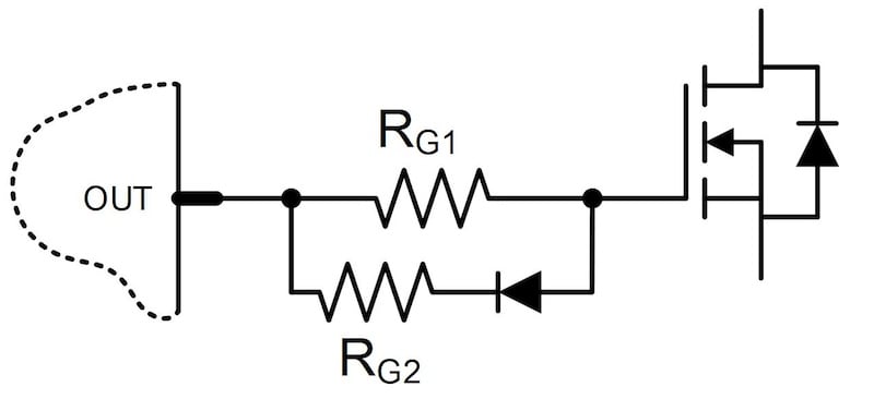

Use a Lower Ohmic Value Turn-Off Gate Resistor (RGOFF)
By using a turn-off gate resistor (RGOFF) with a low ohmic value, we can push the gate driver to sink the gate charge more quickly when the Miller current appears. This prevents CGS from being charged excessively and does not increase the gate driver’s power consumption. If you use this approach, also consider a good layout design with reduced gate-loop inductance. Otherwise, the driver circuit may not be able to evacuate the charges fast enough (see Figure 6). In addition, this solution comes with a tradeoff: Imposing a low-value RGOFF also sets a higher turn-off slope and may create other EMI issues.
Figure 6. Typical configuration to obtain lower RGOFF than RGON on
single-output gate drivers.
Figure 6. Typical configuration to obtain lower RGOFF than RGON on single-output gate drivers.

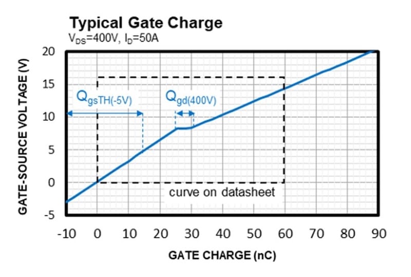

Use (or Increase) the Negative Rail
Setting a negative voltage at which the transistor turns off (VSSO), or increasing the negative voltage if it is already in place, is an alternative way of extending QGS(TH) (see Figures 4 and 5). The main concern for the designer is how to add a negative supply rail for the gate driver’s circuitry. When using a negative rail, a classic bootstrap technique for the high-side driver supply does not work. This may be an inconvenience for compact or low-cost designs.

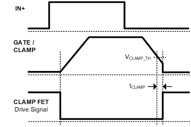

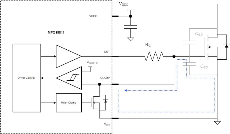

Active Miller Clamp
To avoid shoot-through without jeopardizing the controllability of the gate, we can use Miller clamp circuitry. Some monolithic gate driver ICs, such as the MPQ18811, implement this feature (see Figure 7). In this figure, the clamp discharge path is highlighted in blue.
Figure 7. Active Miller clamp diagram in the MPQ18811 with clamp
discharge path.
Figure 7. Active Miller clamp diagram in the MPQ18811 with clamp discharge path.
The Miller clamp operates in the following manner: shortly after the device has been turned off (VGS almost reaches VSSO) the driver activates the circuitry to clamp the gate. This creates a very low-impedance path between the gate and VSSO (see Figure 8). This path has to be minimized in the layout for optimal results. Because the clamp circuit is an alternate path for the gate loop, it can independently turn our device on and off with the preferred gate resistances and driver rails.
Figure 8. Operation chronogram.

First, the Miller ratio is a good indicator when trying to determine a power FET’s immunity against this phenomenon. Second, the internal structure of silicon carbide cascodes exhibits a reduced reverse transfer capacitance, which improves robustness against the induced turn-on (in relation to its SiC MOSFET counterparts).
Lastly, gate driver ICs such as the MPQ18811 include a Miller clamp. This peripheral is specifically designed to address this issue independently of the FET’s internal parameters or gate driver conditions. A Miller clamp allows the designer to drive any type of power FET without worrying about parasitic Miller turn-on.
