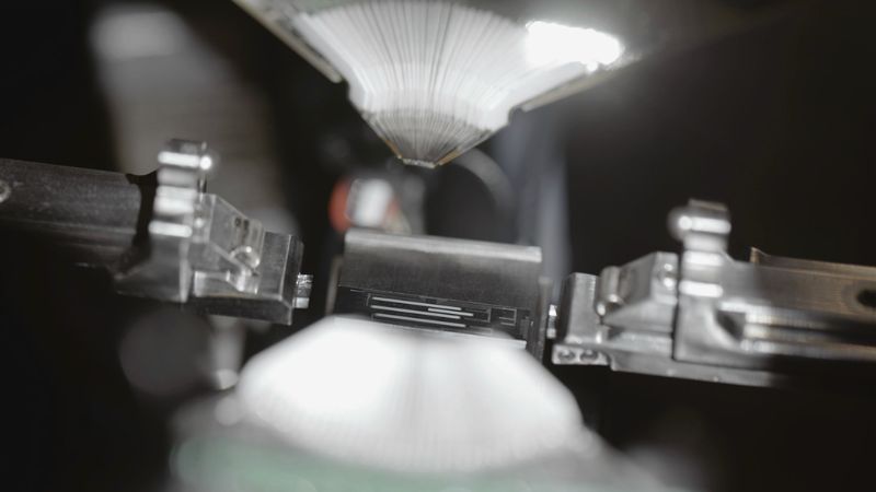

Cisco recently unveiled its Universal Quantum Switch, a research prototype designed to route quantum information between different types of quantum systems without destroying the quantum state during transmission.
Cisco unveils the Cisco Universal Quantum Switch.
Cisco developed the Universal Quantum Switch to help to solve one of the largest challenges in quantum networking: communication between quantum systems that use different encoding methods. By translating between multiple quantum modalities while preserving entanglement and quantum state fidelity, the platform aims to enable distributed quantum computing architectures that scale beyond the limits of standalone quantum processors.

Cisco designed its Universal Quantum Switch to act as a routing layer for quantum systems. When quantum information enters the switch, it can accept the signal in one encoding modality, internally translate it into a neutral routing format, and then output it in the modality required by the receiving system.
Cisco’s Universal Quantum Switch research prototype is designed to route quantum information between different quantum systems without disrupting the quantum state.
Cisco has designed the switch to support several major quantum encoding methods, including polarization, time-bin, frequency-bin, and path encoding. Proof-of-concept testing has so far been completed with polarization encoding, while the remaining methods are still being validated. A key part of the design is that the switch can route and convert quantum information without directly measuring the quantum state, since measuring quantum data can destroy the information being transmitted.
Performance and Infrastructure Considerations
Cisco tested its prototype using internally developed entanglement sources and single-photon detectors. According to Cisco, proof-of-concept testing demonstrated degradation of quantum-state fidelity and entanglement of no more than 4% during conversion and routing operations. The switch also operates at room temperature and uses standard telecom wavelengths over existing fiber infrastructure. That is important because many quantum systems currently require cryogenic cooling or specialized optical infrastructure, both of which create deployment challenges and increase system cost.
Cisco also reports nanosecond-scale electro-optic switching speeds with power consumption below 1 W. While still a research prototype, those characteristics are intended to make the platform more practical for future deployment in data centers and telecom environments.
