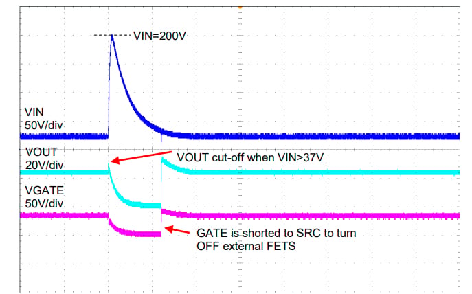

Surge-stopping capability of AP74502 diodes above cutoff voltage
Surge-stopping capability of AP74502 diodes above cutoff voltage.
Importantly, the controllers also have an OVLO pin to set an overvoltage lockout value using a resistor divider. This switches off the gate drive when an overvoltage condition is detected.
