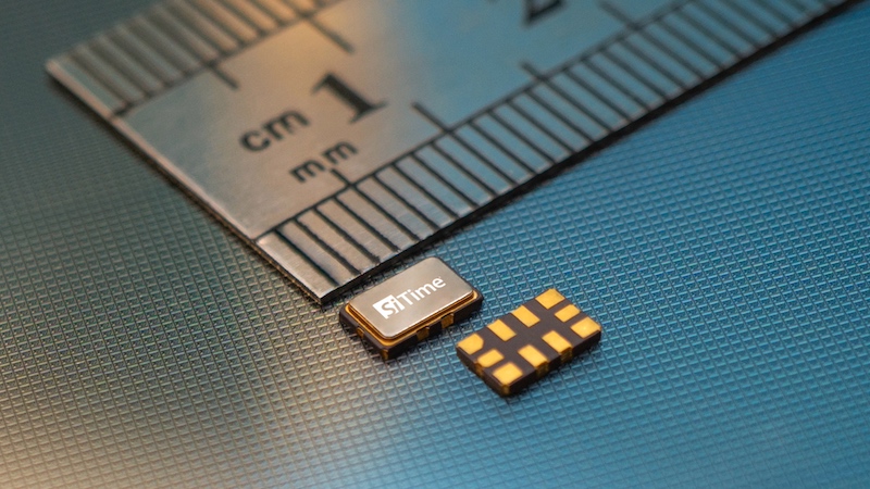

This week, SiTime announced its SiT5977 Super-TCXO, a differential-ended oscillator that joins its Elite RF family as the first single-chip timing solution specifically designed to optimize AI data center efficiency.
SiT5977
The SiT5977 Super-TCXO measures 5 mm x 3.5 mm. Image used courtesy of SiTime

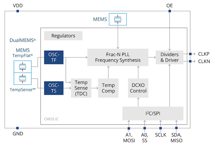

To this end, the SiT5977 Super-TCXO integrates high-frequency stability and low jitter into a single chip, with the product’s hallmark specification being a ±1 ppb/°C frequency slope (dF/dT) stability over temperature.
Internal block diagram of the SiT5977
Internal block diagram of the SiT5977. Image used courtesy of SiTime
dF/dT measures how the oscillator frequency shifts with temperature changes. In high-density AI data centers, rapid thermal gradients occur due to fluctuating workloads and airflow, which could cause oscillators to drift. Therefore, precise dF/dT results in stable operation without frequency drift.
“We meet the ±1 ppb per °C spec over temperature,” Sevalia said. “This stability is critical because, during rapid thermal transients, maintaining precise synchronization ensures no performance drops or data packet loss.”
Part of this performance is due to the SiT5977’s DualMEMS architecture, which ensures impressive thermal coupling by fabricating two resonators on the same silicon die. This design eliminates the thermal lag typical in quartz-based systems, where the physical separation between the crystal resonator and the temperature sensor leads to compensation delays.

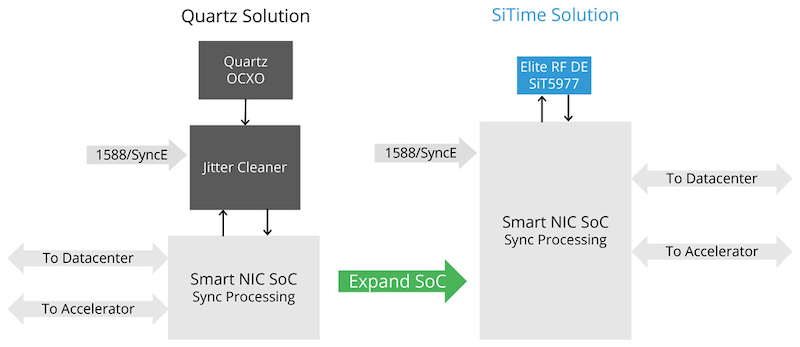

Traditional quartz-based timing solutions often rely on separate devices to manage jitter and stability, resulting in increased design complexity and larger board space. The SiT5977 eliminates the need for external jitter cleaners and voltage regulators by integrating these capabilities into a compact 5 mm x 3.5 mm package.
Reducing the footprint enables system architects to allocate more board space to larger processors and additional components, optimizing processing power while maintaining synchronization across 800-G bandwidth links. This size reduction also supports the increasing trend of integrating high-performance AI compute systems into smaller, more modular architectures.
SiTime’s solution eliminates the need for external jitter cleaners
SiTime’s solution eliminates the need for external jitter cleaners. Image used courtesy of SiTime
SiTime says the space savings don’t come at the cost of performance, either. For example, its jitter is measured at 80 femtoseconds RMS across 12 kHz to 20 MHz. This directly contributes to better AI workload efficiency and lower total cost of ownership (TCO) for data centers since high-bandwidth links remain fully utilized and GPU idle times caused by data bottlenecks are reduced.
“By combining the OCXO and jitter cleaner into a single package, we’re delivering 3x better synchronization and a 4x smaller footprint,” Sevalia said. “This frees up board space, allowing for larger processors and more efficient AI workload utilization.”

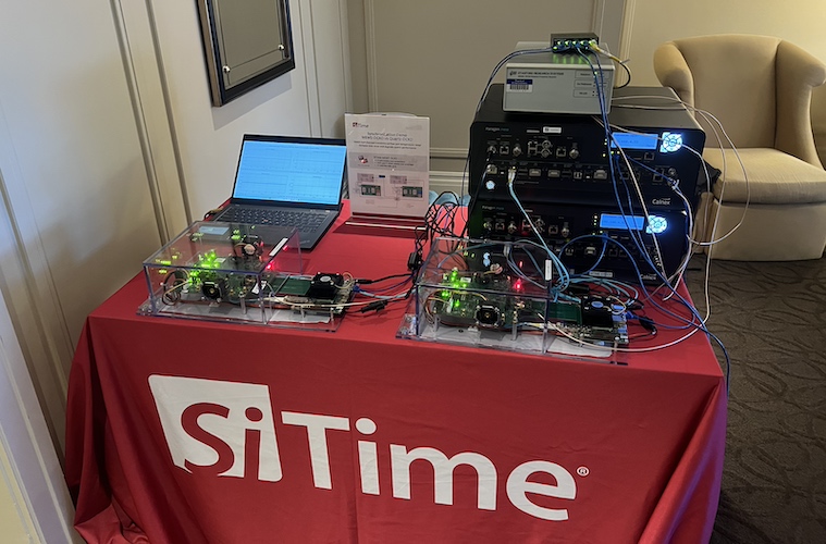

SiTime's CES 2025 synchronization demo
SiTime's CES 2025 synchronization demo of a MEMS OCXO vs. a quartz OCXO.
