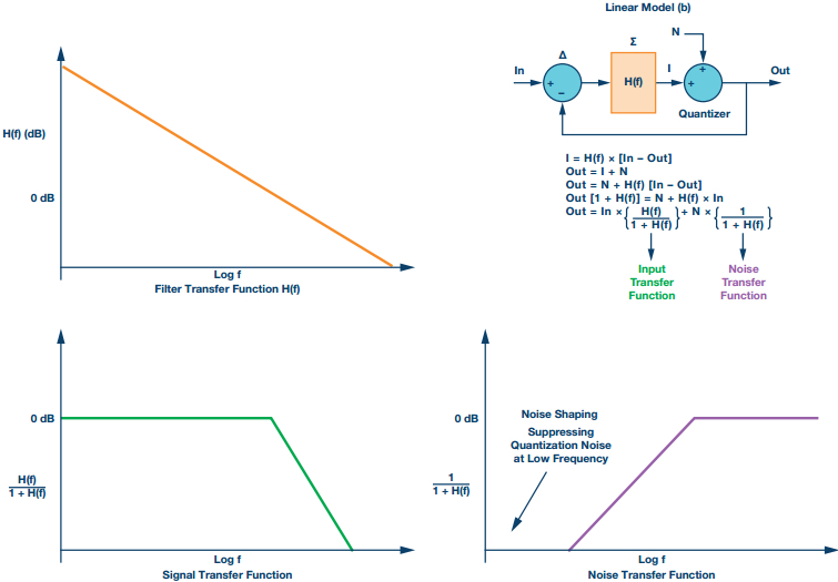

The theory behind sigma-delta ADCs
The theory behind sigma-delta ADCs. Image used courtesy of Analog Devices
Higher sampling rates can help decrease the impact of quantization noise, a type of error during the quantization process of converting continuous analog signals into discrete digital numbers. This noise is inherent to the ADC process and is inversely proportional to the ADC's resolution.
This phenomenon can be better understood through the concept of oversampling, which involves sampling the analog signal at a rate significantly higher than the minimum required by the Nyquist criterion. Oversampling increases the frequency spectrum available for distributing the quantization noise, thereby reducing its density within any given bandwidth. This reduction in noise density translates to an improved signal-to-noise ratio (SNR) within the signal bandwidth, leading to a more accurate representation of the original signal after digital filtering is applied to remove the out-of-band noise.
Oversampling, coupled with noise-shaping techniques such as sigma-delta modulation, can push the quantization noise away from the lower frequencies (where it is most perceptible) to higher frequencies. This enables an even more effective noise reduction within the signal's bandwidth after digital filtering, further enhancing the ADC's effective resolution and accuracy.
