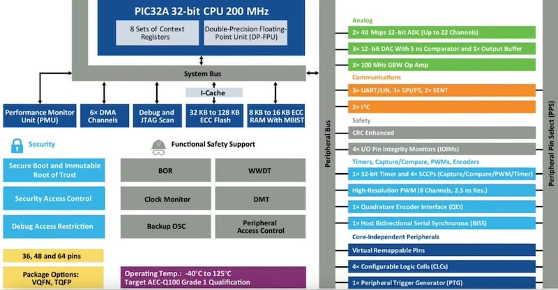

Microchip equipped these MCUs (datasheet linked) with 40 million samples per second (Msps), 12-bit analog-to-digital converters (ADCs), ultra-fast five-ns comparators, and 100-MHz gain bandwidth product (GBWP) operational amplifiers. These advanced peripherals can be used to achieve real-time, high-fidelity data processing, making them useful for applications such as sensor interfacing and edge sensing in a variety of manufacturing industries for consumer electronics. By integrating these analog peripherals directly into the MCU, Microchip reduces the need for additional external components and helps to simplify the design process while minimizing overall system costs.
Block diagram of the PIC32A MCU
Block diagram of the PIC32A MCU. Image used courtesy of Microchip
Another critical aspect of the PIC32A family is its inclusion of a 64-bit floating point unit (FPU) designed to efficiently handle complex, math-intensive operations by quickly and accurately processing floating-point calculations. The FPU is particularly useful in applications that require intensive data processing, such as AI and machine learning algorithms, digital signal processing, and real-time control systems. The FPU's double-precision capabilities execute computations with greater precision to support advanced model-based design approaches.
Microchip has equipped the PIC32A family with hardware safety features, including error code correction (ECC) on flash and RAM and memory built-in self-test (MBIST) for fault detection. These features work together to maintain data integrity and recover the system from potential errors. Mechanisms like an immutable secure boot and flash access control can help safeguard against unauthorized software tampering.
