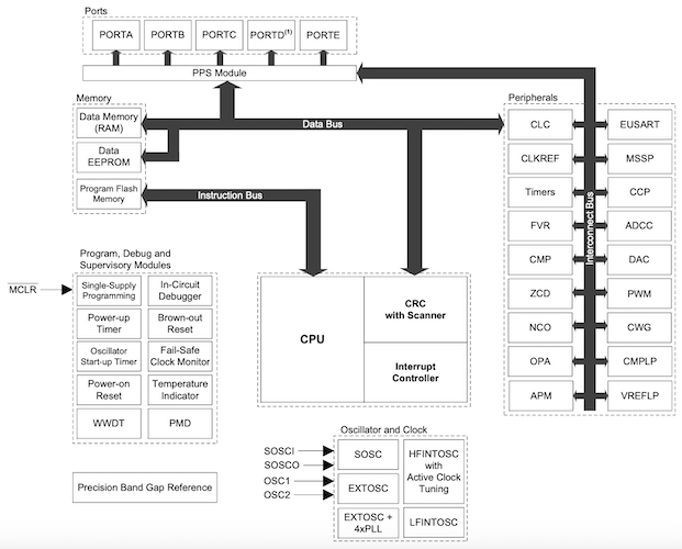

Block diagram of the PIC16F17556/76
Block diagram of the PIC16F17556/76.
