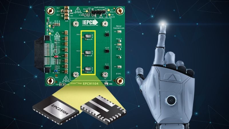

The EPC91104’s compact design allows the evaluation board to be placed closer to the finger and wrist joints.
EPC created the new GaN-based motor drive reference design to support precise motion in humanoid robots, particularly for wrist, finger, and toe joints.
Finer Motor Control and Precision
The EPC91104 evaluation board is a high-performance, three-phase brushless DC motor drive inverter designed to power compact, high-precision motors in humanoid robots. The board uses the EPC23104 ePower Stage IC (datasheet linked) featuring a maximum RDS(on) of 11 mΩ and supports DC bus voltages of up to 80 V.
It operates effectively with a wide voltage range from 14 V to 80 V, accommodating diverse battery systems. A steady-state output current capability of 14 Apk and pulsed current of 20 Apk allows the board to meet the demanding requirements of precision motion in humanoid robotics. The EPC23104 also features a low-distortion switching technology that reduces motor noise and torque ripple.

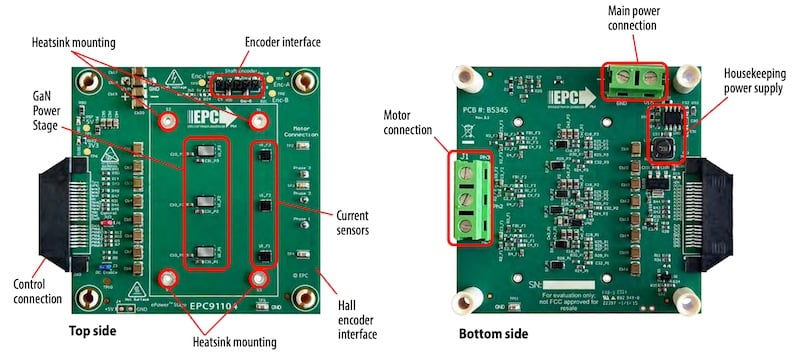

The main sections of the e EPC91104 board
The main sections of the e EPC91104 board.
The EPC91104 includes essential protective features such as overcurrent and input under-voltage protection, ensuring stable operation even in challenging environments. Its compact design allows manufacturers to place it in space-constrained applications—I mean, how much room do you have around your pinky toe? Additionally, the board is compatible with various leading controller manufacturers, providing developers the flexibility for efficient prototyping and integration.

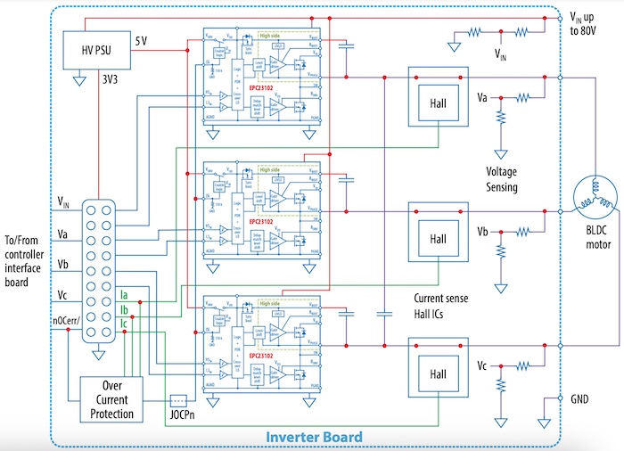

The EPC9176 is a three-phase BLDC motor drive inverter board using the EPC23102 ePower Stage IC (datasheet linked) with a maximum RDS(on) of 6.6 mΩ and 100 V device voltage. It delivers up to 35 Apk (25 ARMS) steady state and 40 Apk pulsed output current. The board includes essential functions for a complete motor drive inverter, such as gate drivers, regulated auxiliary power, voltage and temperature sensing, accurate current sensing, and protection features.
Block diagram of EPC9176 board for a BLDC drive
Block diagram of EPC9176 board for a BLDC drive.
