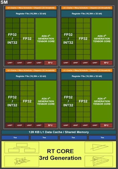

An ADA streaming multiprocessor
An ADA streaming multiprocessor.
On a lower level, the device incorporates 2,816 CUDA cores and is derived from the AD107 silicon, which originally contained 24 streaming multiprocessors (SMs) equivalent to 3,072 CUDA cores. However, only 22 SMs are enabled in this model. This configuration places the RTX 2000's performance between the GeForce RTX 4050 Mobile, with 2,560 CUDA cores, and the GeForce RTX 4060, with 3,072 CUDA cores.
It features 192 fourth-generation Tensor cores and 22 third-generation RT cores. Single-precision performance is rated at 12.0 TFLOPS, RT core performance at 27.7 TFLOPS, and Tensor performance at 191.9 TFLOPS. The GPU is equipped with 16 GB of GDDR6 memory with ECC, utilizing a 128-bit memory interface that offers a bandwidth of 224 GB/s. The maximum power consumption of the device, however, remains conservative at 70 W, negating the need for external power connectors. Connectivity is facilitated through four mini DisplayPort 1.4a outputs.

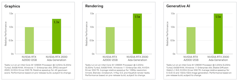

Nvidia RTX 2000 ADA Generation performance uplifts
Nvidia RTX 2000 ADA Generation performance uplifts over the Nvidia RTX A2000 12GB.
Notably, this GPU shows substantial performance uplifts, ranging from 1.3X to 1.6X, with significant improvements observed in generative AI workloads. In comparative benchmarks, it delivers twice the performance of the older Quadro P2200 in Solidworks SPECviewperf 2020 and up to four times the performance in Solidworks Visualize benchmarks​​.
