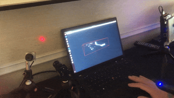

The Prophesee demo shows the data captured by both a conventional and event-based camera from the same input.
To demonstrate the value of event-based sensing over conventional cameras, Butin set up an IMX636 sensor next to a conventional camera and displayed the captured data on a computer. The results spoke for themselves: while the traditional camera could only capture a certain number of frames per second, the event-based camera captured frames whenever it detected motion.
A traditional camera (left) only captures information at a given frame rate, with information lost between each frame. An event-based sensor (right) captures data whenever it detects motion.
“If you use traditional frame-based sensors, before the first frame and between each frame, you’re basically blind by design," Butin said. "There’s a ton of data that gets missed, and that’s a big deal when a machine is trying to intercept motion in the real world.”

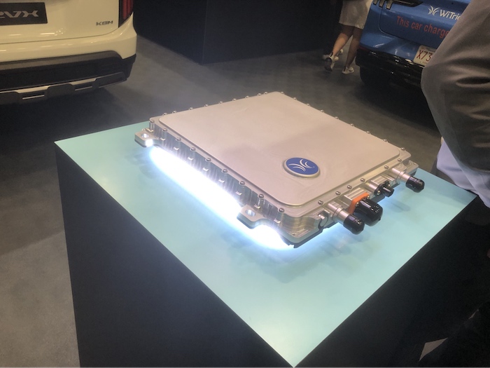

A WiTricity Halo receiver.
The company’s charging system is called WiTricity Halo and consists of a power hub transmitter, a receiver on the EV, and cloud-connected software for tracking charging performance. The charging portion of the system operates on the principle of magnetic resonance charging, involving two resonant circuits—one in the charger and one in the device—that resonate at the same frequency. When these circuits resonate in harmony, energy is efficiently transferred over a distance, acting as a more convenient and flexible charging solution than inductive charging.

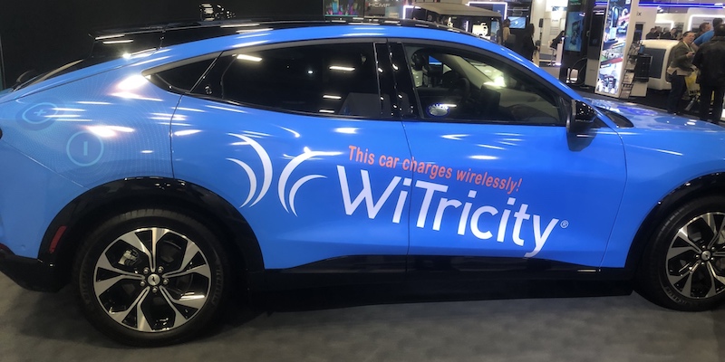

A Ford Mach-E equipped with WiTricity charging.
To access WiTricity charging, vehicles must be integrated with the receiver from the start or be retrofitted through an authorized dealer. WiTricity claims its technology can mitigate range anxiety by improving the cumbersome process of conventional wired charging.

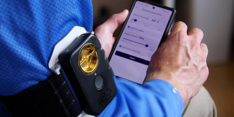

Iona Tech, previously spotlighted on All About Circuits, has developed a unique wireless electrostatic discharge (ESD) protection device called the StatIQ Band. This armband wearable can determine body voltage based on the body’s electric field. A companion app can then alert users to changes in voltage and notable charging and discharging in real time.
The StatIQ Band and companion app. Image used courtesy of Iona Tech
The StatIQ Band can help prevent ESD events by notifying users when bodily voltages reach unsafe levels. This transparency into ESD events can prevent related device failures.
I met with Iona’s CEO, Daan Stevenson, who allowed me to try out the StatIQ Wearable firsthand. As an EE, I’ve spent countless hours chasing my tail to prevent ESD or solve a failure caused by an ESD event. Wearing the StatIQ Band was the first time I saw ESD as a tangible, quantifiable, and manageable problem. I could see my bodily voltage change based on where I was, what I was touching, and what I was doing, giving me new, valuable insights into the nature of ESD.
