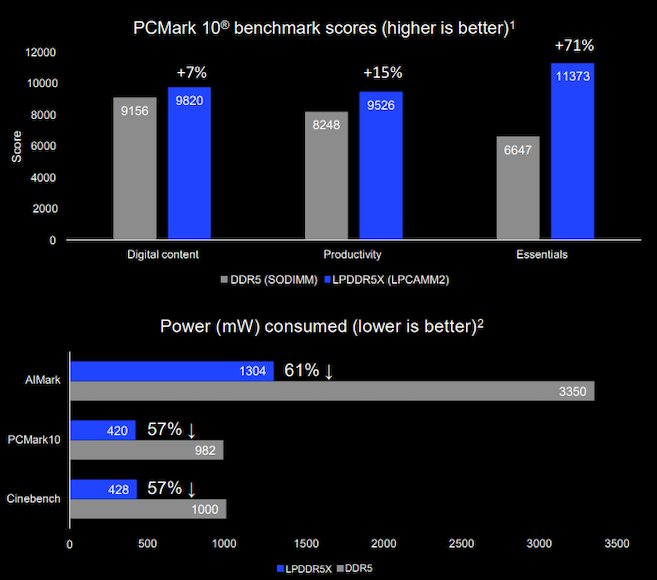

Micro LPCAMM2 performance benchmark results

  • LPDDR5X-based LPCAMM2 reaches speeds up to 9600 Mbps compared to 5600Mbps with current DDR5 SODIMMs.Up to 80% lower system standby power and 43-58% lower active power per 64-bit bus than SODIMM-based memory.
  • 128-bit wide memory bus compared to 64 bit with SODIMM, meaning that each LCCAMM2 effectively replaces two SODIMM modules.
  • Utilizes a single PCB for all module capacities with chip positions designed to improve host PCB routing and shorter data paths.
  • PCMark 10 benchmark predicts 7% better performance for digital content creation and 15% improvement for productivity workloads.
