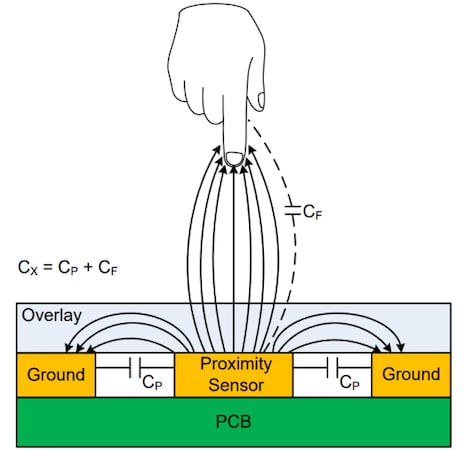

Infineon’s Capsense technology is a capacitive sensing system built into PSoC microcontrollers to support high-resolution proximity and touch detection with low power operation. It uses both self-capacitance and mutual-capacitance techniques. Self-capacitance is based on the change in capacitance between a sensor pad and ground, while mutual capacitance is based on the variation between a transmitter and receiver electrode pair. The system measures changes in femtofarad-level capacitance to detect the approach or presence of a conductive object. These changes are digitized by a capacitance-to-digital converter and processed as “raw counts,” which the firmware compares against a baseline to determine activation events.
Electric field lines coupling to a human finger
Electric field lines coupling to a human finger.
The Capsense subsystem incorporates a hardware-based sigma-delta modulator (CSD) and advanced analog front-end filtering, integrated into a multi-scan converter low-power (MSCLP) architecture. This architecture enables always-on capacitive sensing while consuming less than 8 µA in deep sleep mode. It also supports autonomous wake-up on touch without waking the CPU. Capsense achieves a signal-to-noise ratio greater than 5:1 by using dynamic baseline tracking and digital filtering techniques such as IIR and CIC2 filters.
To support directional detection and large proximity ranges, the system allows designers to implement loop or trace sensors with optimized shield electrode placement. Shielding minimizes parasitic capacitance and environmental coupling.
