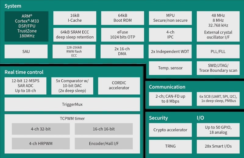

Block diagram of the PSOC Control C3
Block diagram of the PSOC Control C3.
The Main Line devices, supporting clock speeds up to 180 MHz, integrate a digital signal processor (DSP) and floating-point unit (FPU) to facilitate high-resolution control in power conversion applications. The MCUs also include high-resolution pulse-width modulators (HRPWMs) with sub-100 ps accuracy to generate the precise output waveforms needed to harness the advantages of SiC and GaN transistors.
Advanced analog processing capabilities, such as a 12-bit SAR ADC operating at 12 MSPS and parallel sampling of up to 16 channels, allow accurate real-time data capture for current and voltage measurements. These features collectively enhance system efficiency and reduce energy losses for high-speed motor drives and power supply designs.
