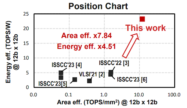

From a raw compute perspective, MediaTek's NVE reaches a peak performance of 16.5 TOPS and a maximum operating frequency of 1,300 MHz. More important, however, is the area and energy efficiency of the system.
MediaTek reports its NVE outperforms competitors
MediaTek reports its NVE outperforms competitors in both energy efficiency and area efficiency.
With a footprint of just 1.328 mm by 1.032 mm, the NVE packs in 1,073 KB of on-chip memory and 6,336 at 12 b x 12 b of MAC, ultimately boasting an area efficiency of 12.0 TOPS/mm2. This marks a 4.51x improvement over the preceding technology.
At the same time, the device’s energy efficiency reaches 23.2 TOPS/W when processing 4K video at 30 fps and 16.3 TOPS/W when processing 4K video at 60 fps. This marks a 7.84x improvement over the preceding technology.
