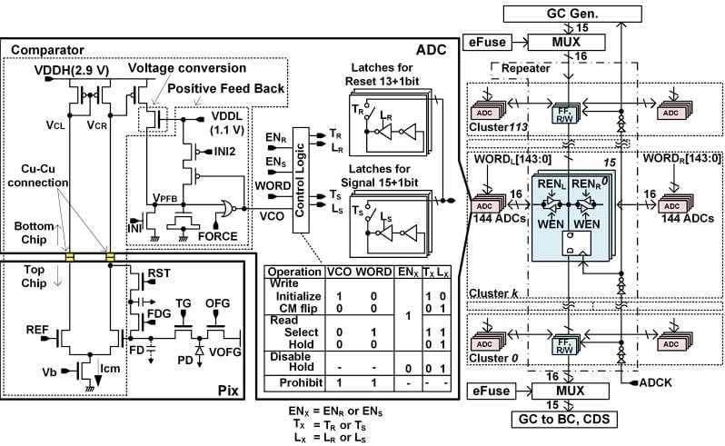

At the logic chip, the reference current converts to a voltage that can be digitized and used to provide a readout of the image. A key innovation of the chip is that each 8×1 group of pixels has an associated 4×2 array of ADCs immediately underneath them, making bonding and routing simpler and providing a high density of ADCs.
The block diagram of a single pixel and processing chain
The block diagram of a single pixel and processing chain demonstrates how Sony was able to densely integrate the ADCs with good power efficiency and high speeds.
Some highlights of this chip are a maximum frame rate of 120 fps, an associated resolution of 25.2 MP (with 50.4 million Cu-Cu bonds), and a 2.66 e-rms random noise. In addition, the power consumption of the chip is very low, with a reported 1545 mW of consumption for the 25.2-MP design. In all, the Sony GS image sensor reports a FoM of 0.083, placing it well within striking distance of standard rolling shutter architectures and making it a more viable option for commercialization.
