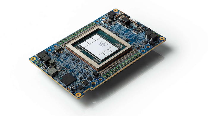

Intel validated Intel has validated its AI product portfolio
Intel validated its AI product portfolio for the first Llama 3 8B and 70B models. Image used courtesy of Intel
Intel also collaborated with Meta in developing Llama 3 for data center-level processors. Intel optimized its Gaudi 2 AI accelerators for Llama 2, Meta's prior version of the LLM, and has now demonstrated the accelerators' compatibility with Llama 3. Intel’s Xeon, Core Ultra, and Arc processors have also been validated with Llama 3.

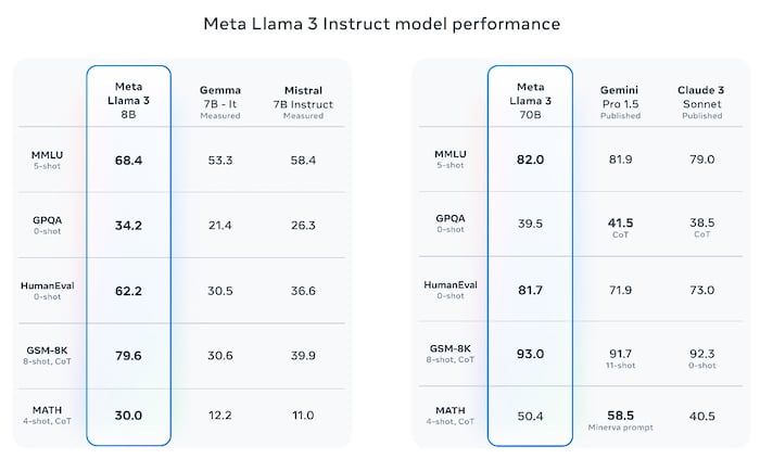

Llama 3 8B and 70B performance measures
Llama 3 8B and 70B performance measures. Image used courtesy of Meta
In zero-shot learning (0-shot) tests, the AI model is not specifically trained on the data used in the question. For example, the AI model will be asked to identify a duck when it has not been trained with examples of ducks. Instead, it must infer a result based on semantic relationships.
In n-shot learning (n > 0) tests, the model has been trained with at least n examples of test question data. Chain of thought (CoT) tests AI reasoning for complex tasks like math and physics. Meta tested Llama with a new human evaluation set containing 1,800 prompts covering 12 common use cases.
