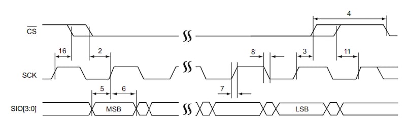

The 23AA02M/23LCV02M serial input timing diagram
The 23AA02M/23LCV02M serial input timing diagram. Image used courtesy of Microchip
These SRAMs support a single-voltage, read-and-write operation, with the 23AA02M and 23AA04M variants accommodating a range from 1.7 V to 3.6 V, and the 23LCV02M and 23LCV04M designed for a slightly narrower range of 2.2 V to 3.6 V. This flexibility caters to low-power applications and those requiring more power efficiency. In that same vein, these SRAMs address power consumption concerns with low active read current specifications (6 mA max at 40 MHz, 3.6 V for SPI/SDI/SQI) and a standby current of just 140 μA typical at 25°C.
