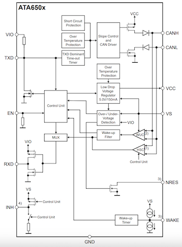

Integrating a CAN FD transceiver and a 5-V/150-mA low-dropout voltage regulator, the ATA650X series (datasheet linked) supports data rates up to 8 Mbit/s and adheres to ISO 11898-2:2024 and SAE J2962-2 standards. The voltage regulator provides an output voltage with a precision of ±2% and a dropout voltage of up to 750 mV at 150-mA loads. It delivers a maximum current of 150 mA, supplying power to the transceiver, microcontroller, and external components.
Designed for harsh conditions, the ATA650X can operate across a wide temperature range of -40°C to +150°C and with supply voltages from 4.5 V to 28 V, handling transients up to 40 V. Microchip designed the CANH and CANL pins for high reliability, withstanding transient voltages of ±150 V and offering ESD protection up to ±6 kV (IEC 61000-4-2).
ATA650x simplified block diagram
ATA650x simplified block diagram. Image used courtesy of Microchip
From a power perspective, the device supports multiple operating modes, including Normal, Sleep, Standby, and Receive Only modes and ISO 11898-2-compliant wake-up functionality. In Sleep mode, the device achieves a low current consumption of 15 µA at 25°C. In normal operating mode, the internal transceiver consumes 50 mA during a dominant bus state, leaving 100 mA from the LDO available for external loads.
