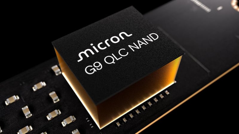

QLC NAND
The Micron 2600 SSD, built with the industry’s first 9th-generation (G9) QLC NAND in an SSD.
G9 also brings a 28% smaller package footprint (11.5 mm x 13.5 mm) compared to competitive NAND options. That’s especially important in space-constrained designs like thin-and-light laptops or handheld gaming consoles, where storage real estate is limited.
