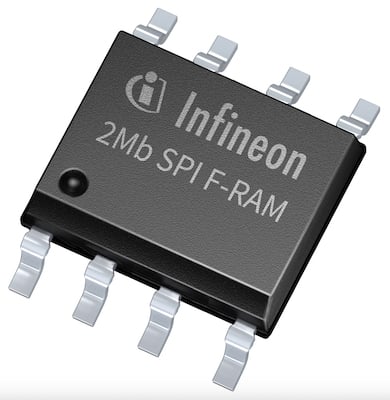

Infineon’s NewSpace memory portfolio includes three product families: low-power, radiation-tolerant F-RAMs, QSPI NOR flash, and pSRAMs. Image used courtesy of Infineon
The new memory lineup includes three product families: Ferroelectric RAM (F-RAM), QSPI NOR Flash, and pseudo-static RAM (pSRAM). The F-RAM devices offer non-volatile storage with ultra-low power and high endurance, capable of operating from -55°C to +125°C and tolerating total ionizing doses (TID) up to 50 krad(Si).
For code storage and execution, the NOR Flash series supports 256 Mbit and 512 Mbit densities, operates between -40°C and +125°C, and is rated for 30 krad(Si) TID. Meanwhile, Infineon’s pSRAM, which internally behaves like DRAM but provides an SRAM-compatible interface, is designed for high-throughput buffering applications. These are the first pSRAMs specifically positioned for the NewSpace market. They are accordingly rated at 100 krad(Si) and are notable for their low pin count and high-speed operation.

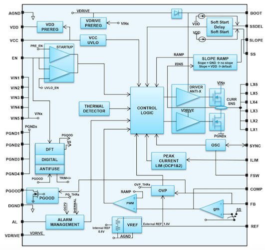

STMicroelectronics has released the LEOPOL1, a radiation-hardened, monolithic point-of-load (PoL) DC-DC converter tailored for power management in low Earth orbit (LEO) spacecraft. Part of ST’s expanding portfolio for the NewSpace sector, the LEOPOL1 (datasheet linked) leverages space-grade silicon-on-insulator (BCD6-SOI) technology and is hardened by design to withstand key radiation challenges of LEO environments, making it particularly attractive for satellite OEMs seeking a cost-effective alternative to traditional hermetic packaging.
The device can deliver up to 7 A in ground-level (non-radiative) conditions and up to 5 A in harsh radiation environments (up to 62 MeV·cm²/mg), with stable operation from 3 V to 12 V input. It features a fully integrated synchronous buck topology with internal power MOSFETs and supports programmable output voltages from 0.8 V up to 85% of VIN. Designed to meet a 50 krad(Si) total ionizing dose (TID), the LEOPOL1 is also single-event latch-up (SEL)-free at LET levels up to 62 MeV·cm²/mg and immune to non-ionizing energy loss (TNID) at 3×10¹¹ protons/cm², ensuring mission reliability over multi-year LEO lifespans.
Block diagram of the LEOPOL1
Block diagram of the LEOPOL1. Image used courtesy of STMicroelectronics
Beyond its radiation resilience, the LEOPOL1 offers several advanced features: configurable soft-start, current sharing via out-of-phase synchronization, full protection (OVP, OCP, OTP, UVLO), and real-time Power Good signaling. Its flexible interleaving and master/slave synchronization allow multiple units to be combined for scalable current delivery in multi-rail systems, such as FPGAs and onboard computing platforms.

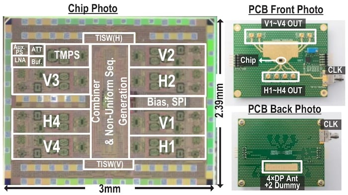

These images depict the receiver developed in the study
These images depict the receiver developed in the study, which was implemented in a small integrated circuit and mounted on a printed circuit board for testing purposes. Image used courtesy of the Institute of Science Tokyo
This new method dramatically reduces the silicon area and power requirements by eliminating the need for a dedicated receiver chain per antenna-stream combination. Instead, fast switching circuits dynamically reroute signal paths through shared hardware, allowing eight data streams to be demultiplexed with high fidelity from a single chip. The prototype receiver, built in 65-nm CMOS, operates at 3.2 GHz and integrates high-speed phase shifters and synchronized switches to handle both horizontal and vertical polarizations in a 4 × 4 MIMO configuration.
The result is an impressive 38.4 Gbps throughput, representing a record for millimeter-wave phased-array MIMO receivers, achieved with minimal area and power consumption. These innovations position the technology as a strong candidate for integration into compact satellite transceivers, mobile devices, and Internet of Things (IoT) endpoints supporting hybrid terrestrial/non-terrestrial 5G and 6G communications.
