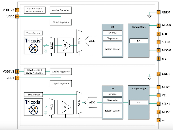

Melexis recently announced the MLX90384, an 18-bit angular encoder IC that will be the first product featuring Melexis’ new Arcminaxis technology. Historically, robotic design required a trade-off between performance and cost in position tracking solutions. Optical solutions offer high precision but are costly, while magnetic dipole-based solutions are more affordable at the cost of accuracy. Arcminaxis technology aims to bridge this gap by delivering magnetic sensors with better precision, making it a middle-ground solution for robotics and automation applications.
Functional block diagram of the MLX90384
Functional block diagram of the MLX90384. Image used courtesy of Melexis (Link downloads datasheet as PDF)
The MLX90384 IC (link downloads datasheet as PDF) is a magnetic position sensor featuring an 18-bit resolution and a pitch-independent design that accommodates magnets of various sizes and pole pair configurations. This makes it highly adaptable to different magnet designs. The Arcminaxis technology provides features aimed at reducing design complexity. Its magnet-sensor tolerance of ±0.5 mm simplifies mechanical assembly. Its nominal air gap of 1.5 mm allows the sensor and magnet to be operated and mounted within a robotic joint safely. It also features multi-axis magnetic field sensing (axial and tangential), which eliminates the need for precise sensor placements.
Allegro claims these features help reduce sensor and magnet costs while minimizing design complexity by enabling easier assembly and integration. The MLX90384 is available as a four-component set consisting of the sensor IC, a Vernier-type magnet, a precompiled STM32-based software package, and a reference design for custom encoder solutions. An evaluation kit is also available for testing and development.

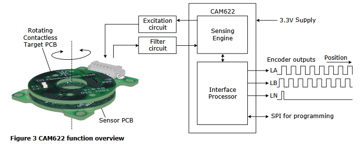

CambridgeIC showcased its new CAM622 resonant inductive encoder ICs at SPS Nuremberg 2024. The CAM622 measures position through a sensing engine and generates encoder-style (ABN) outputs through its interface processor.
In the past, the sensors came in PCBs with etched coil patterns and used standard PCB fabrication methods. Targets, on the other hand, came in the form of PCBs with transponder coils that are harder to assemble and manufacture. Like other CambridgeIC processors, the CAM622 uses a specialized approach: the IC’s sensing engine connects to compatible "sensors" to perform angle measurements of a contactless rotating mounted "target." Both the sensors and targets are resonant inductive circuits embedded in a PCB.
CAM622’s function overview.
CAM622’s function overview. Image used courtesy of CambridgeIC (Datasheet link downloads as a PDF)
CAM622 leverages rotating targets to use PCB coils. It accomplishes this by increasing operating frequency and tweaking the circuit’s quality factors. This means that the new Type-B sensors and Type-B targets can be manufactured using PCB fabrication techniques and assembled more quickly. The sensors and targets are designed symmetrically to reduce the need for precise alignment and come in outside diameters of 25 mm, 30 mm, and 50 mm. Customers can obtain Gerber files for the sensors and targets and manufacture parts themselves.
CAM622 also features an update to its interface processor. Compared to the previous CAM502, the CAM622 has an internal sample rate benchmark six times faster at 33,000 measurements per second. It works on an SPI interface primarily used for configuration and diagnostics of the ABN outputs that can double as an output interface. The CAM622 ABN board is available for evaluation and testing.
